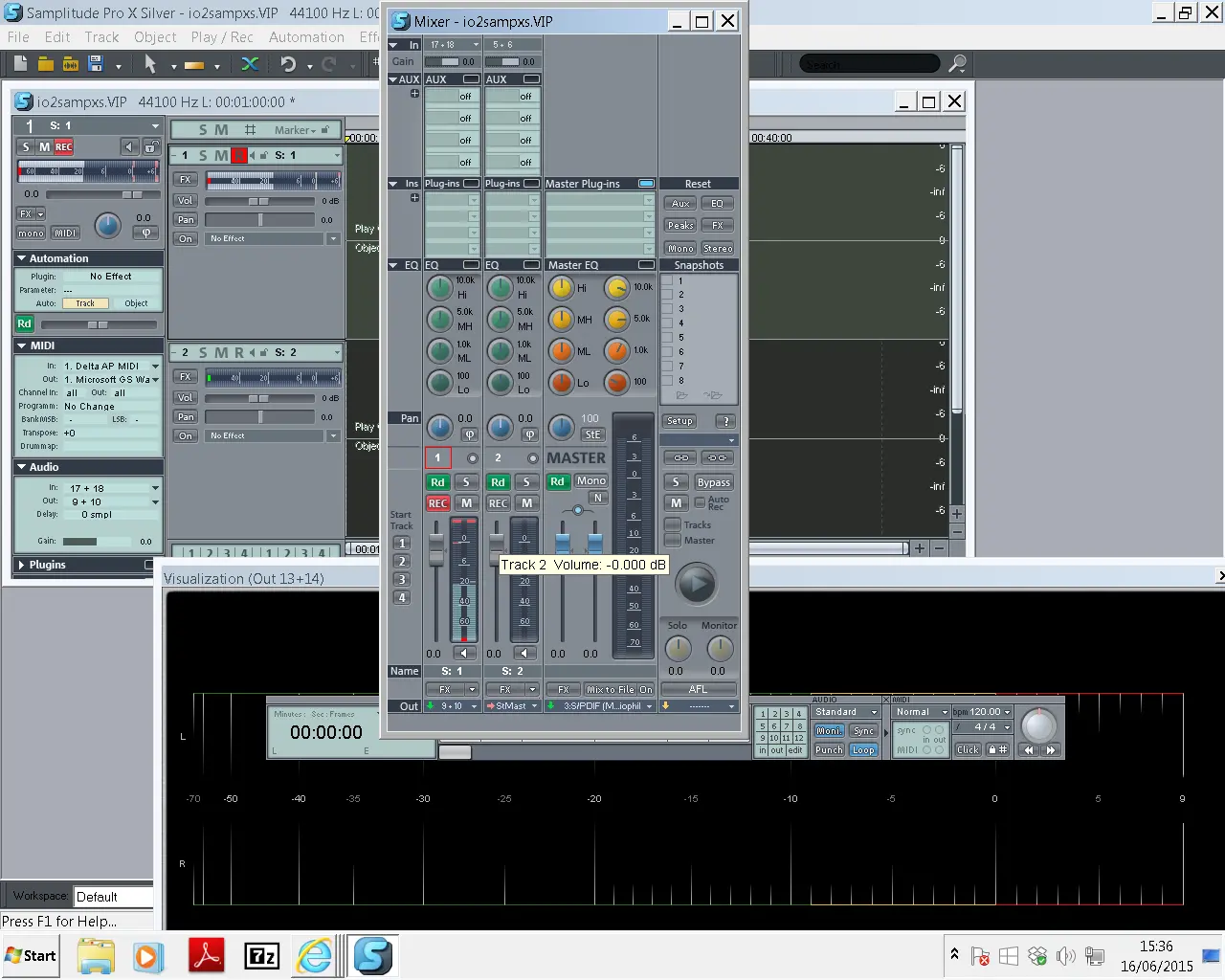

There you go, attached is a grab of Sam proX silver getting mic signals from the iO2 (AKG P150 and SM57) . The modulation you can see in the mixer pane is pickup of the Brahms piece playing on radio3.
The AI was found quite easily and running MME drivers I can have both USB audio and the PCI card recording and/or playing at the same time (I could even connect and select further USB interfaces and have done in the past) .

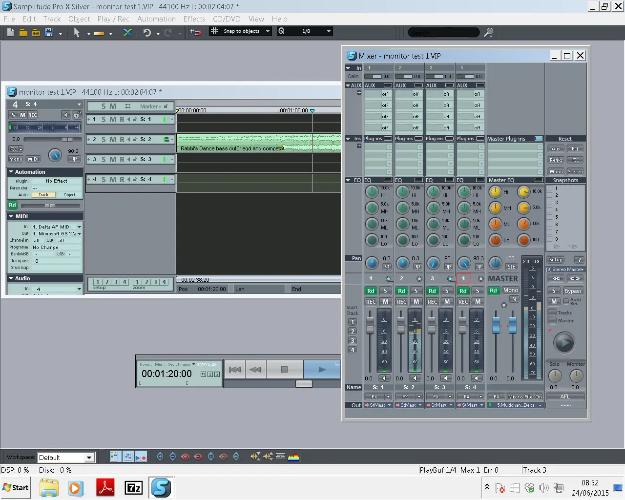

Anyhoosydoosies, I think I can help. First you need to setup 8 "mono" tracks from the "start new project" pane.
Then click on tracks 8, 7, 6, 5 and delete them (or you have a problem).
Take you clip as a .wav (44.1kHz, same bits for everything) and drag it into (say) track 2 (you WILL be asked things. Do them!) .

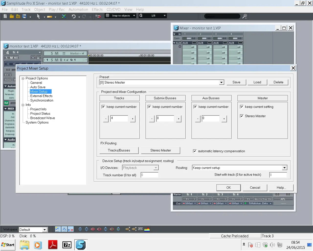

Top bar find "View" open mixer. If you have no master fader click "Master". Near that is "Setup" This gives you the box attached. Click at the top to get options and select Master.
Now, if you are lucky, track 2 will playback thru the master monitoring path....The while you SHOULD be able to record to track 1.
The permutations are vast and you will probably struggle for a long time to sort this. Took me a good 1/2 hour. My system is not really set up for this and I am loathe to tear it down to try! (in any event I have a car to fix and a poorly lady to look after) .
Tip! Put the cursor arrow anywhere in the track pane and press y on the keyboard. A vast setup selection will appear allowing you to change many parameters.
