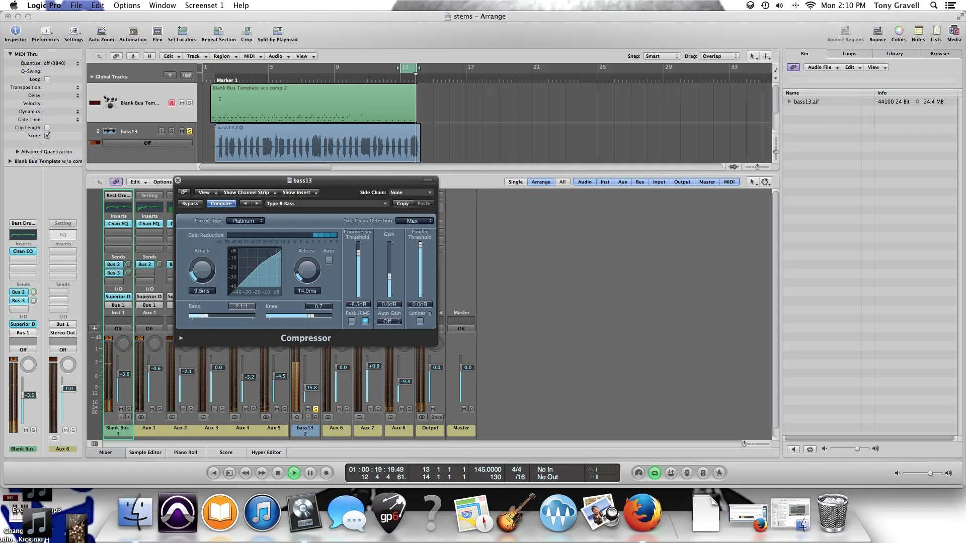

This is my first time ever using a forum so I apologize for any mistakes and/or stupid questions I have, feel free to poke fun to the point I understand what I am being stupid about because I am open to all criticism or advice. When using a compressor, how much gain reduction is common or appropriate for an instrument with a lot of dynamic range such as bass? I'm not looking for a number because I'm aware every knob should always be set individually, but I'm looking for your personal opinions on what you've discovered so I can understand what I am doing or doing wrong. Do I want to see the gain reduction level hitting the same db level? Is it okay if it fluctuates between different dbs or am I trying to stop this by using a different ratio? I know this is a lot to answer but any help at all is much appreciated. It is frustrating after monthes of still not understanding what is helping or hurting my signal.

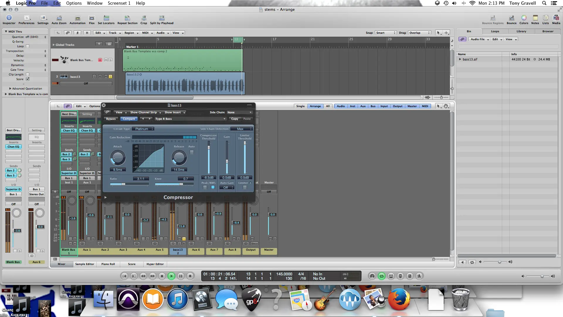

Edit: I attached two photos of the same note with a ratio of 2:1 and 3:1. They both have a gain reduction 3 that does not change. I may be wrong but isn't the ratio supposed to change the amount of gain reduction?

when you use compressors, the important thing is to watch and see how much it is compressing - very often the incoming audio is simply below the threshold, so the compressor isn't compressing. It's a very common thing and people strain their ears for signs the compressor is doing something. Ramp up the input, or adjust the threshold so the line with the knee drops down, will start to compress and then you can hear it - then the ratio and other gizmos can be heard changing.

From your OP, yes you're right. 2:1 and 3:1 should show a different gain reduction with everything else being equal. I'm not sure what's going on there. :eek:
Try zeroing that 'knee out. There's enough soft slope there to perhaps over shadow the rather small ratio dif.
Also, you might see a lot more reduction -and indicated in the meters if you increase the release a bunch. Now you have a wider (and longer) window to compare.
Also.. here's one the might be part of it as well! You have 'limiter like speeds set in attack/release, but the detector is set for RMS. Not a lot of average program going on in those short amounts of time.
@mixsit After messing with the knee a bit, it seems to seriously affect how much everything changes. This may be obvious, but when you read about a lot of compressors people tend to say "don't touch the knee" or make it seem unimportant. Do you know anything else about what this particular function does? Switching to peak does help as well where as the rms seems to have more of an affect, but because my settings are "limiter like" should I stay on peak? Thanks mate! :listeningmusic:

Hard knee means there's an instant transition from no compressor to compression right at the threshold.
Soft knee effectively implements a variable ratio around the threshold point, so compression kicks in more gently for audio that only just passes (or approaches) the threshold.
Anything that exceeds the threshold by a bit amount is hit just as hard as it would be with a hard knee, as far as I know.

Never heard of 'not messing with the knee. It comes down to a taste and a bit (or more :) of sound and reaction difference is all. For what it's worth (nothing) I tend to spend more time in hard knee, and work more with the time and dector options.

Yep. And at low ratios, you could see were it might make for a quite subtle dif.

The gain reduction depends on the Threshold combined with the ratio.
It's not just the ratio that's doing the job.

To Quote this: I may be wrong but isn't the ratio supposed to change the amount of gain reduction?
Well, not quite right, to put it simple, the ratio is the amount of gain reduction after the threshold has been reached.
A signal hits threshold at 2:1 the gain reduction is 2 db for every 1 db above threshold, if the ratio is 3:1 then the amount of gain reduction is 3 db for every 1 db above threshold.
So the quote is right in that the ratio changes the amount of gain reduction, but the gain still rises above threshold but the amount it raises is reduced.
Clear as mud?
