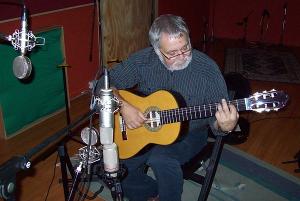

I recorded a Flamenco album, solo nylon stringed classical guitar, during sound check I tried 2 different LCD mics but could not decide on which one as both had good points (neither were bad). So I set them up with one upside down on top of the other so they were as close to the same position as possible. I set them up about 500mm out front of the guitar. I also was interested to hear a ribbon mic in the setup so I put a ribbon right alongside the 2 LCDS, I also set up a ribbon room mic (I think I flipped the phase) about 1mtr out front at head hight.
All the tracking was done with each mic going to a separate track. During mixing all the tracks were blended to get the desired sound, I did pan the mics a little for spread, but it was not done as a stereo effect as I don't like stereo single guitars much, very little eq was added or subtracted.
There were a few different guitars used and the different guitars work best with different mic blending as one guitar was dark sounding and another bright. The album came out very nice and natural sounding, with a touch of reverb added flamenco style. I have attached an image from the session.
The answer, use as many as you like, then you can mix it how you want it with lots of options.
