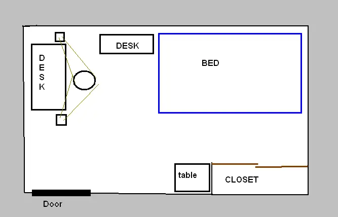

*edit* I forgot that I made a really crappy MS Paint diagram of the room I'm going to be in. The little squares by the desk are monitors. Hah. Anyway. Everyone else seemed to be doing it so I just went ahead and did it in case it'll help. I don't think I can attatch it without reposting, so I'll answer my own post with it.
Christopher
Here ya go.

if you have the space, you might wanna conider putting your desk away from corners/walls. From looking at your your picture, your right speaker will probably be louder than the other. Plus the bass frequency will be louder than usual by placing your speakers close to the walls.
