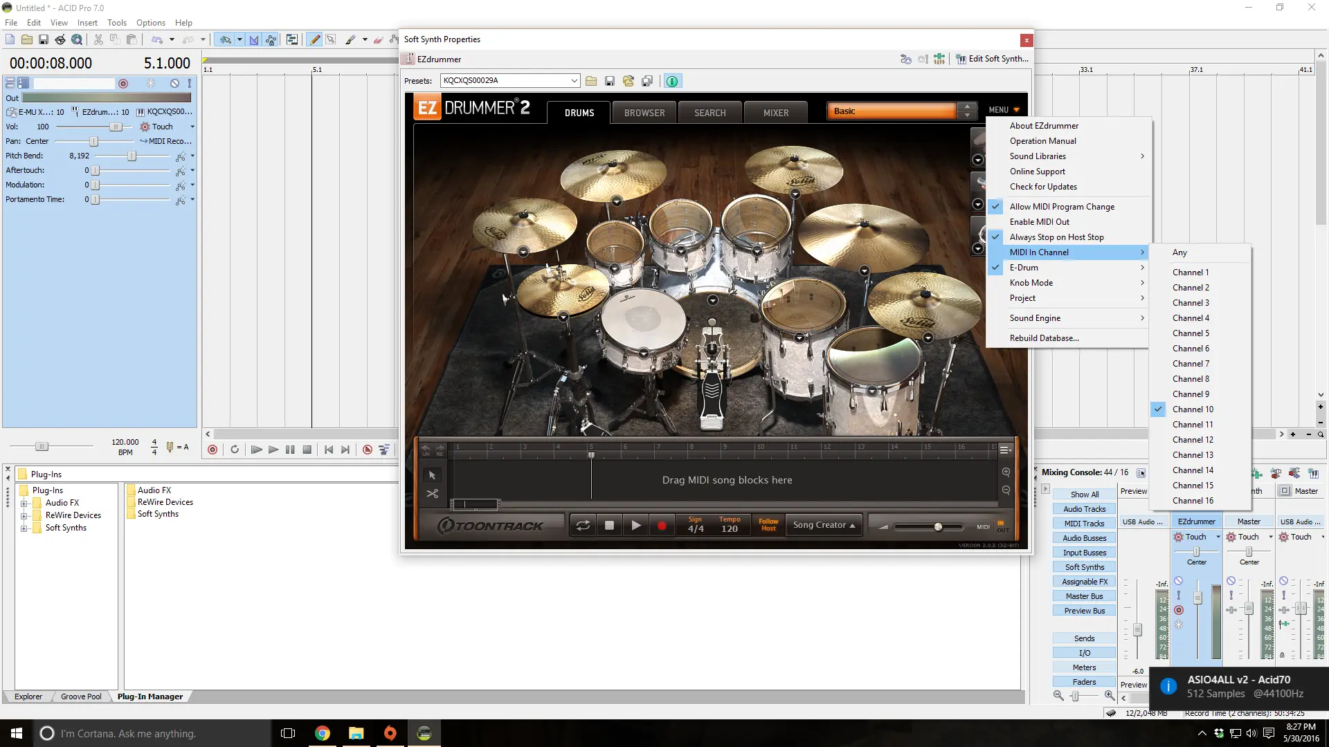

Thanks for the response. I set both Acid and EZdrummer to MIDI channel 10. I was looking through the manual but didn't see anything on mapping notes. Here is what I have so far. acid 7.webp
If any other information is needed to better troubleshoot the issue I can provide it. I know this should work but I think the issue may be with the settings in Acid. Do I need a 3rd party VST to assign the notes?
