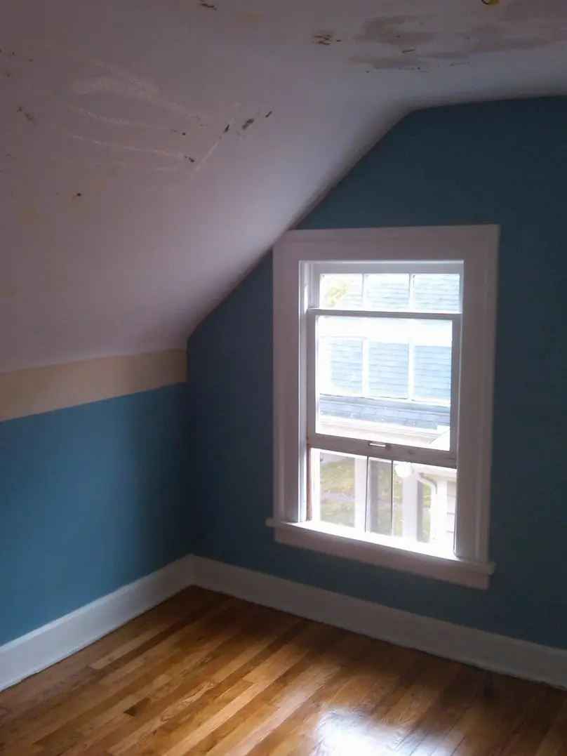

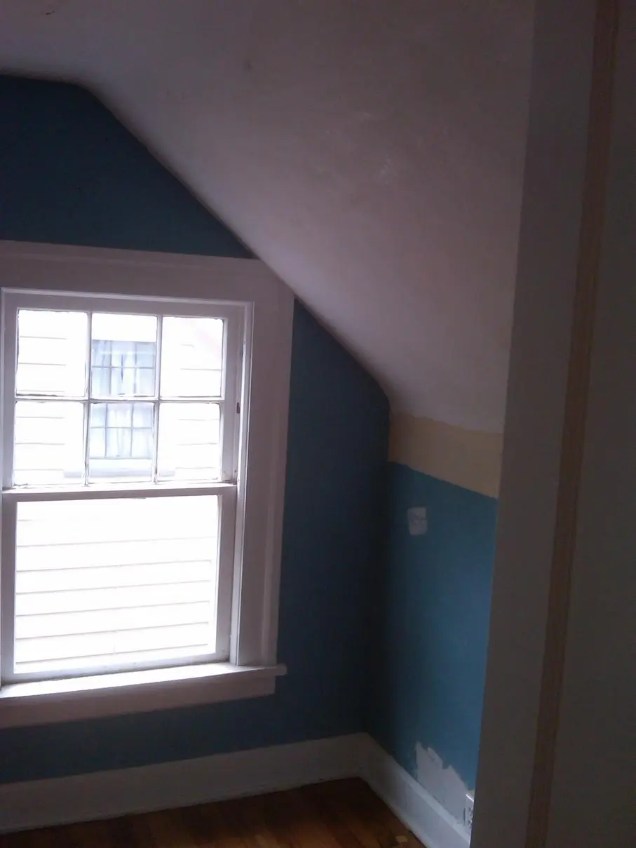

I'm in the process of a studio remodel. My control room is on a third floor with about a three foot knee wall on two sides and a slanted ceiling after that. The slant behind where the speakers will be and at the wall behind me across from the speakers. I have ridgid fiberglass bass traps for the upright corners. What should I do with the slanted corners?

No. It slants up to a flat ceiling. The slanted part is about 4 feet long. I'll post a pick when the floor is dry.
Here are a couple of pics of the angles.

You'll treat that like a room with a normal ceiling. Absorbers at the side-wall and ceiling reflection points, plus as many corner bass traps as you can manage. The side-wall reflection points might not be the same as for a flat wall, but the old "mirror trick" will easily find them.
