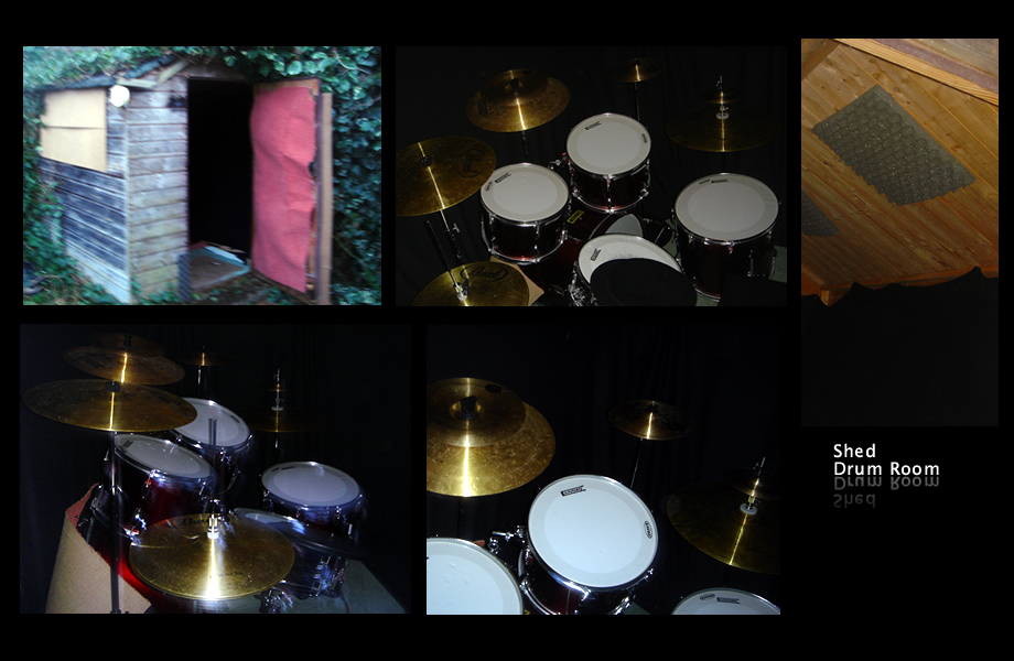

Ok, so i had an old crappy shed full of rubbish and I wanted a drum kit... and i was offered a kit for £50 that sounded pretty decent.. so i didnt turn it down...
After fighting the mass of 8-legged crawlers i finally managed to empty the shed and begin work..
* first of all i covered the entire inside space with waterproof lining...
* then i smashed out the remaining windows as some of them has previously been broken
* i boarded the windows up from the inside with hardwood
* filled the window frames with insulation and boarded them up on the outside
* i re-boarded the entire inside of the shed using the framework and filling the gap with insulation
* i then insulated the door and covered it in carpet
* i made overlapping extensions onto the outer door and added seals to door edges
* i carpeted the floor
* hung fabric on the inside to cover all the messy hardwood
at first the drum kit could be clearly heard from inside my house but now you can only really hear the kick drum and snare
what can i add to the shed / kit to make the drum kit quieter? Ive even put silencing pads on the kick drum without much difference
any solutions?
-tm

Nice one, thanks for the replies. Unfortunately i cant really do much more to the shed as the roof is weak and i dont want the thing to look too horrific from the outside. The shed was sitting on a cement block so i didnt see much point in doing anything to the floor (except carpeting it... but that was for sound issues..).. anyway i think im gonna deal with it as it is as ive had no complains from neighbors yet and the parents dont seem to mind. My best idea is to add a few of those sliding locks to the inside so when i get in and lock them up the door is pushed firmly closed, because at the moment that seems to be my weakest point, by far.
Il post a picture of what ive got so far....
