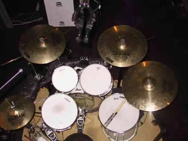

Here's the Modified Spaced Mics. It's difficult to get a good picture of the mic placements.
Both mics are 38 inches from the snare center and pointing at the snare and 54 inches from where the beater strikes the kick head. One mic is directly above the Snare and the other mic is peaking over the drummers shoulder.
This places the snare and kick in the center of the image.

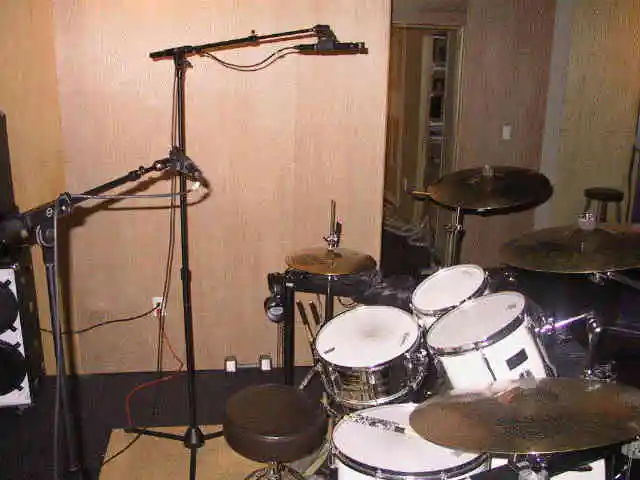

Here's the Spaced Mics.
The mics are on a mic bar and are positioned about 38 inches above the snare and centered over the kit. The mics are positioned over the drums and not directly over the cymbals.

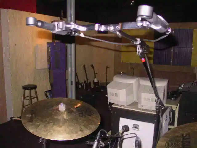

Here's the Coincident Mics.
Again, the mics are on a mic bar and are positioned about 38 inches above the snare.

Hey sonix
thanks for the pics and the clips, really helps to give a picture to go with the sound.
Couple questions for you. I noticed you had a head taped to your kick, how do you like that and how did you get it to stick so tight? I tried it once but it just didn't lay very nicely and securely for my likings, but it could be the tape I used. Also, did you have any sound dampening inside the kick with the extra head on?
Once again, thanks for the clips and the link to the modified spaced mics tip. I tried it out, showed the drummer the sound of his kit with just the overheads and he was quite surprised.

Hey Grandflash13,
The head is a Evans G1 Clear and I taped it with really thick Duct tape. It's sort of loose and it gives click and slap that I like. No padding inside.
The modified spaced micing technique clip does not do justice... when the kick and tom resonant mics are added, the kit really fills out.

uh... arent you supposed to point the mics at the drums, not away as the picture shows?
foreverain4,
I'm not sure what you mean... the mics are side address SDC and are pointed at the drums
