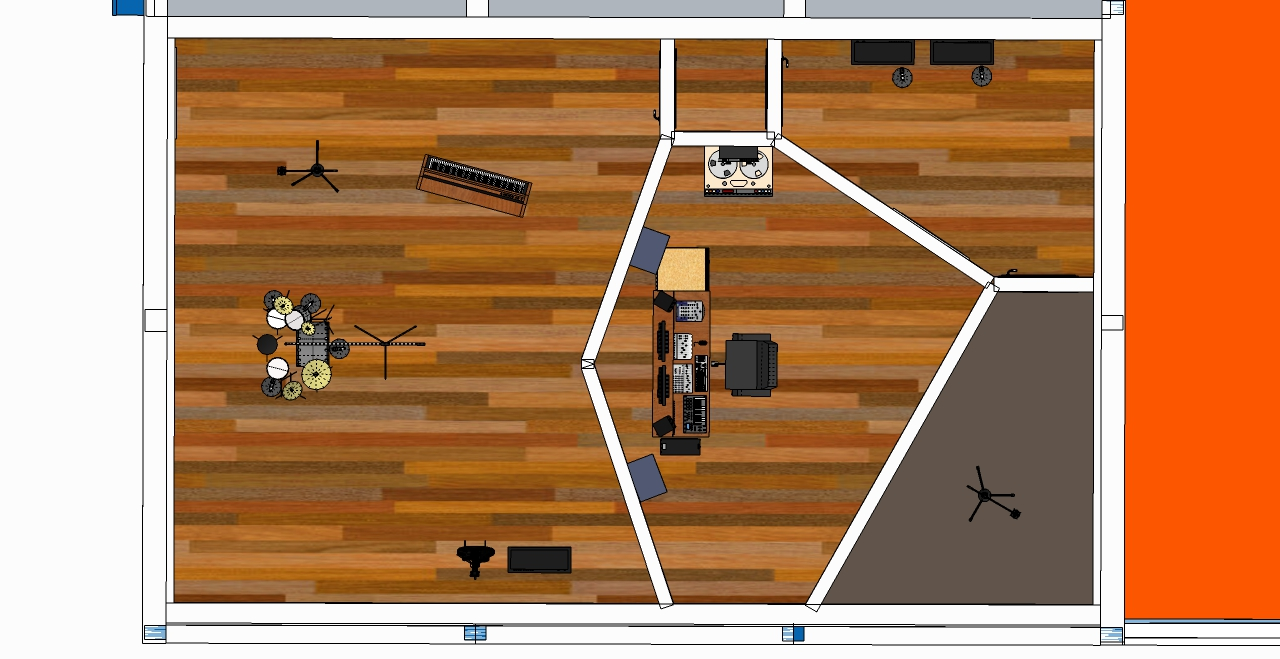

So our plan now is to build internal walls to divide the space into 4 rooms, as seen on the image below:
Large live room to the left, then control room in the centre with windows into each of the three adjoining rooms. The rooms to the right are multi-purpose, one heavily treated and the other with minimal treatment. You can ignore the little "air-lock" room at the top as we are probably going to leave that one out now and just put a door from control room to live room.
The walls will be staggered stud 600mm spacing on two 75mm wide wall/ceiling plates with a gap of 10mm between them. All timber attached to concrete walls/ceiling/floor will have rubber/foam to isolate. Then we plan to lay two layers of 12mm sheetrock/gypps on each side with green glue between the sheets. And also 100mm rock wool within the cavity.
I would really appreciate some educated opinions on how we have planned the space, both acoustically and logically. The main room that I am questioning the shape of for acoustics and comfort is the control room. If you wanna get an idea of the sizes the space is 11.5x7.1m with a 3.4m high ceiling. We plan to have a lower, sloped ceiling in control room. We will start to lay timber for the walls today or tomorrow. Thanks in advance for the help!
