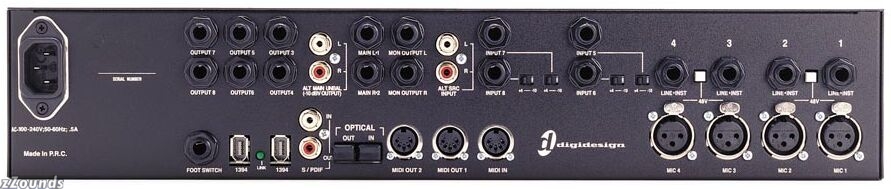

Since I use 12-18 tracks I was wondering if I could get all of it done in 1 tracking.The Digi 002 nonly has 8 analog ins, but 4 XLR inputs (my drum machine has 2 XLR outs), a S/PDIF input(my keyboards all atleast have one out), and 2 RCA inputs(my drum machien has a RCA out) could I record using all of those at the same time?
Second what are the midi syncing options on this, I dont see anything on the picture???
Also what are ADAT optical(the digi rack has 8 ins and outs)?I've never heard of it before, I think one of my keyboards has it
none of the analog inputs on the 002 are stereo. they are all mono.
the 002 has 8 analog inputs (either 8 1/4" or 4 XLR and 4 1/4") and 10 digital inputs.
The ADAT optical on the unit is for a device that supports ADAT optical connection on it (such as some preamps or mixers) and can give you 8 more tracks. the S/PDIF is only 2 tracks. As far as the RCA inputs, if you choose to use them, you can't use 7-8 1/4" at the same time.
by MIDI sync, what do you mean? right next to the optical in are 2 MIDI outs and 1 MIDI in for anything that requires MIDI (either MMC or synths).
