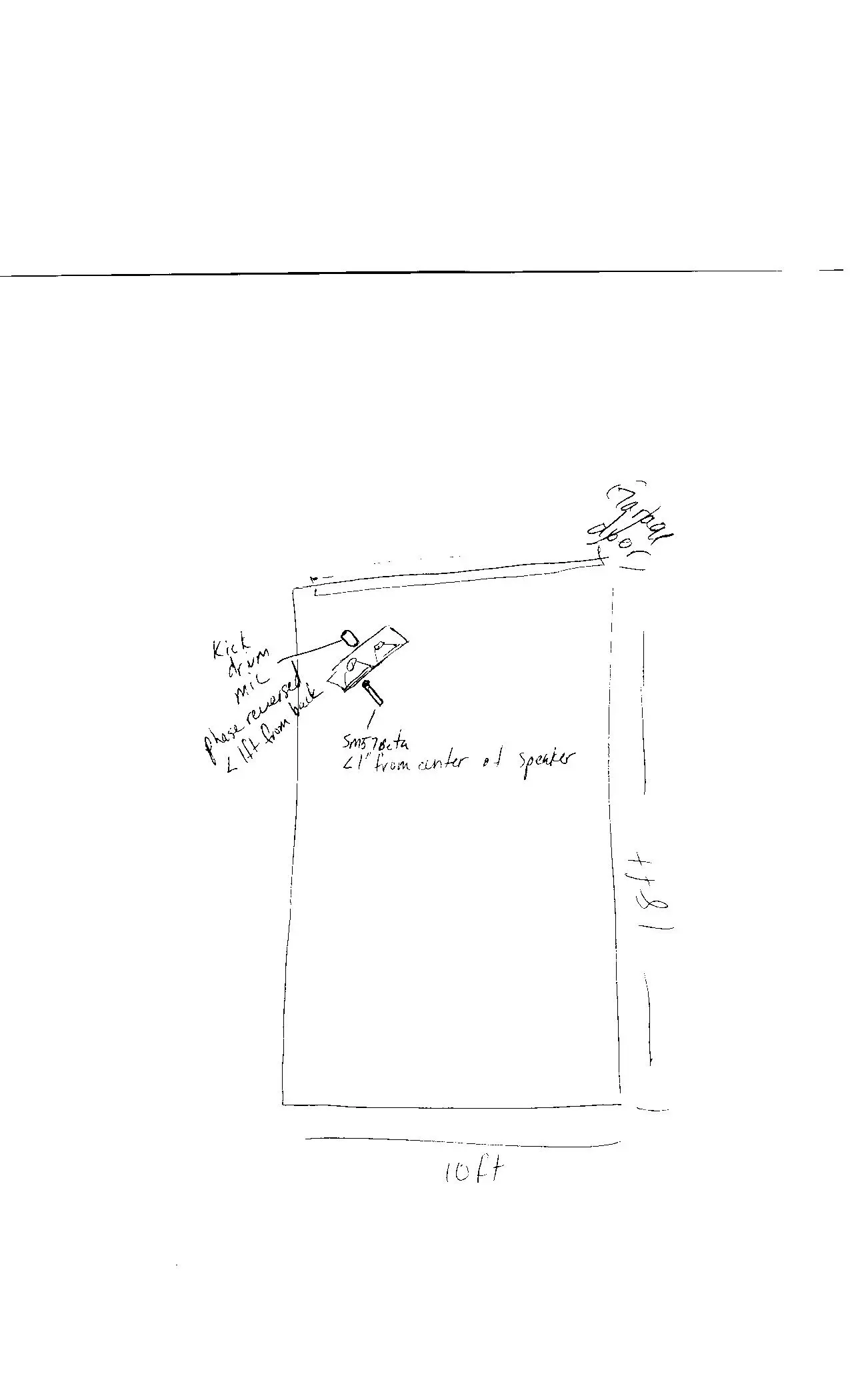

Now remember I'M NOT RECORDING DRUMS just rythm and lead for extreme thrash/death style metal, which many of you have heard now. I am recording my own music so I guess I'm a little anal about the guitar sound, but I NEED PERFECTION OR I WILL GO CRAZY!!! :| I'm using new mic cable, and monster cable for instrument and speaker. I'm recording in a 10X18 garage which I had a little trouble with innitially with room reflection and bass reverb, but with close micing I solved it. Now to my exact trouble. No matter how I place the mics, I can get a great soundng sick mid range howl and screaming hi's, but absolutely no bottom end palm mute crunch. Like I said the amp sounds great in the garage standing out there riffing. but when heard through the monitors theres no tight low end chunky palm mute. Especially if I track 2 tracks of rythm and pan them, the "chug chug chug" gets lost in the kick drum riff. HELP!!! Ill attatch a sketch of my setup maybe you can tell by that.

Alrighty then. First thing I see is that the mic is facing head on in the center of the speaker cone. The mic should be off to the left of center of the cone, closer to the edge of the speaker. Second you should also turn the mic so its facing perpendicualr to the cone where the mic is. Micing the center of any speaker will cause alot of high end shrill, sometimes painful if your doing pinch harmonics. (plexis touched on this) The trick is to move the mic where its not picking up the extreme hf transients. Put the amp up on some blocks to get some air under the cabinet, and throw a heavy blanket over it all. Sometimes I will even face the amp into the corner with the mic about 2 inches away from the grill to pick up some fast reflections ala Yngwie Malmsteen. Ive gotten stellar sounds out of Crates before so I see no reason for other people not to. Every amp has a sweet spot.
Funnily, each time I`m recording nu-metal or similar, it almost always sounds the best with the 57`jammed into the center of the cone....
That depends on the amp and speaker, there are no set rules!
In fact, center of cone is my "default" poisition......Angling the mic slightly can really help too.....
getting the cab up from the floor helps a lot, it`s amazing how those early reflections can sneak their way into your mic, good advice.

Consider yourself to have been blessed.:p Im highly sensitive to hf in distorted guitars. I guess if your amp is a little less edgy than it might not be a problem. Strings can also contribute to the problem. New strings are usually too bright for me.
True, the dead give away it the diameter of the cone itself regardless of speaker size. A 12 inch speaker with a 1 inch diameter cone will nearly always have more hf off the center mic position. 2x12 cabinets are usually kind of hard to yank the low end bump when doing palming the open E or whatever tuning your using. If the amp sound great in the garage, use a combo of the recomendations here and add a large diameter condensor room mic about where you normally listen to the amp. See if it helps.

Yeah, they can be heplful sometimes. I have a table to mic stand sitting on bricks with carpet under the stand and under the bricks with no less that 2 blankets over the cabinet. Plus its all inside a box made of 2X4's and drywall with insulation inside like a normal wall. The head is sitting outside the box in between my main monitors where I can tweek the settings. Its too loud to have anywhere else.
