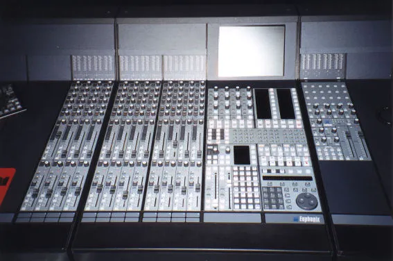

Or one that looks like this:
(attached)
I hear ya man. My little Yamaha O1V controls the faders and some other functions within my DAW, but how sweet would it be to have a console that could control nearly everything, with individual chanel strips on the board, coresponding to individual chanel strips on the DAW?
VERY!
