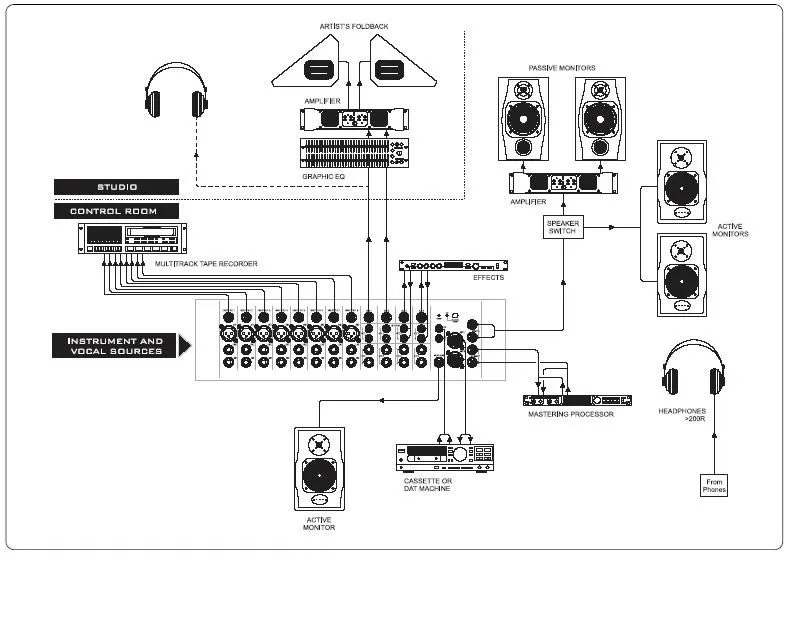

k this is what i have....just wondering if anyone would suggest a different way of hookin it up.
Behringer MX3282
Lexicon Omega
Sony Computer
AT 4033
M-audio TAMPA
Wharfedale Diamond Series 8.2
Nady Drum Mic Kit (7 pieces)
Shure SM-57
Behringer DI Box
i need to hook up a guitar, bass, and the drums .... how would you guys do it
what do u mean by hooking it up. how everything connects to each other or what better stuff to get?
how does everything connect ....but you can suggest things to buy too! :D
you bought all that and dont know how to hook it up?
no i do i just wanna see what everyone eles thinks maybe i could get better quality or something
nady goes into the board. The AT 4033 goes into the tampa, then into the lexicon. The 57 and the DI can go into the preamps on the lexicon. Then have your main outs on the board go into line inputs on the lexicon. That should use 5 of the 6 inputs, and have the 2 outputs going direct to the monitors.
Follow the schematic
the multitrack recorder would be the lexicon to the cpu...

everyone took this thread the wrong way i do know how to hook it all up i was just wondering if anyone had any ideas.... man i got bashed :eek:
this is how i hook it up ok:
AT 4033>M-audio TAMPA>Omega
Nady 7 Piece>Mixer>Subgroup 1-2 outs>Omega
Shure Sm-57 and Nady CM-88 on guitar amp>Mixer>Subgroup 3-4 Outs> Omega
Bass>Behringer DI Box>omega
