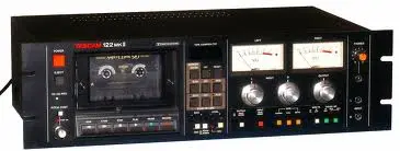

A functional 3 head cassette deck with respectable specifications will likely sell for around 100 bucks and up depending on make and model. Decks like a TASCAM 122Mk II or or Mk III would be good choices for actual production duties and there's usually lots of those available on eBay and elsewhere.

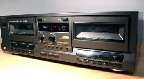

The RS-D550W is relatively low end. There are even better 2-transport dubbing decks from Technics, such as the RS-TR232, but this may not be the way to go for your purposes.

Nonetheless, this is not the type of cassette deck you'd need. I agree that a Tascam 122 would be a much better solution.

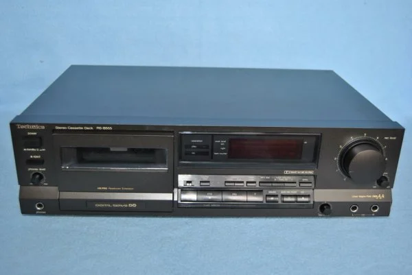

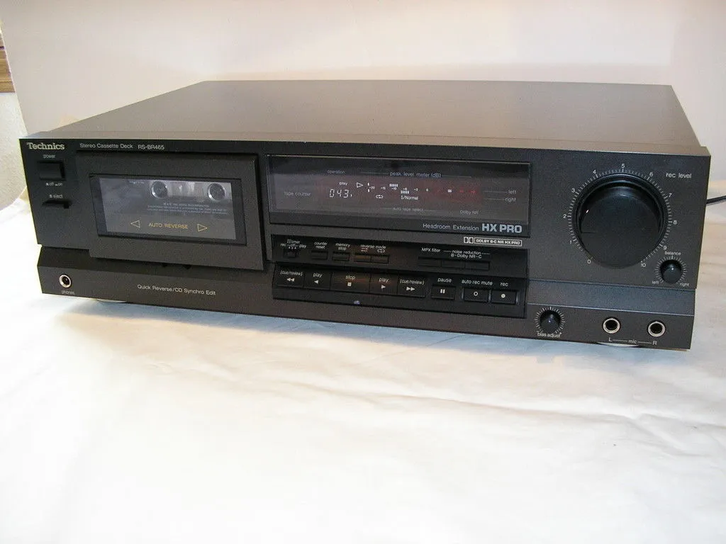

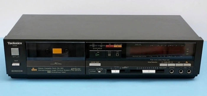

However, I am also fond of Technics cassette decks, with the RS-955 being one of my favorites. It may seem nothing special, but I think it's an exceedingly good cassette deck. Also, something like the more modern RS-BR465 (autoreverse) and the RS-B555 (I think) are great single well cassette decks.
