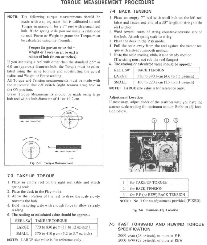

I've made .gif file of "torque" page from teac a3440 manual so you may get some general idea. See attached image. That's all I can do. Also I am not sure if this is what you need to be taking care of.
