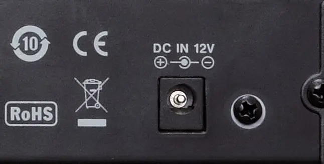

Apologies if there are various versions, but from what I can see the us1800 takes 12v DC with positive at the pin.
In the U.S. the supplied adapter will be rated for 110v input voltage, but the actual tascam unit will be the same anywhere in the world.
You can pick up a UK mains 12v DC adaptor for a few quid at a local store, or even on ebay.
You probably already have one somewhere.
The only thing you can really get wrong is buying one that has negative at the pin.
There's usually a little picture to show you, just like the one on the back of the us1800.

Oh, sorry. I should have mentioned that you should always match or exceed the amp rating when replacing a PSU. :facepalm:
So if the one that comes with it is 12v DC 500mA, then your replacement should be at least that.
Other than that, it's completely safe to buy a replacement.
