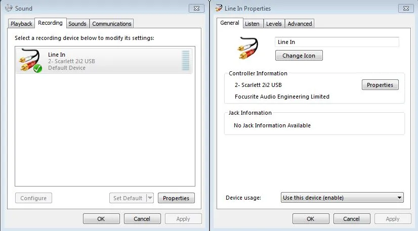

When you go into Control Panel-->Sound and click the Recording tab at the top, what do you see?
You should be able to click the sound device and click properties at the bottom...
