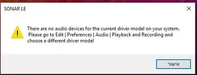

Another issue. and perhaps it is related to my problem,
Every time I open the program I get a message: (I attached a photocopy of the message).
And then I have to reboot my computer, or disconnect and reconnect the sound card.
Thanks!!

Like I said, when I reboot my computer, or disconnect and reconnect the sound card, and open sonar again, its work and "sonar" identifies the drivers and the Asio driver.
