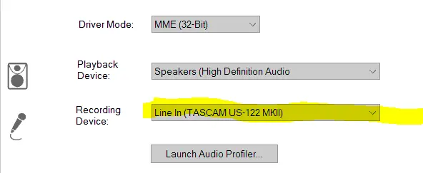

Music Creator can "see" the Tascam as a device for input.

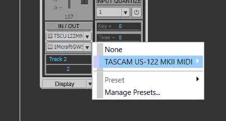

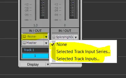

However, I cannot get Music Creator to use the Tascam as an input - it is not listed as available for Audio tracks
The Tascam does show up on Midi tracks but I am assuming that is not what.
