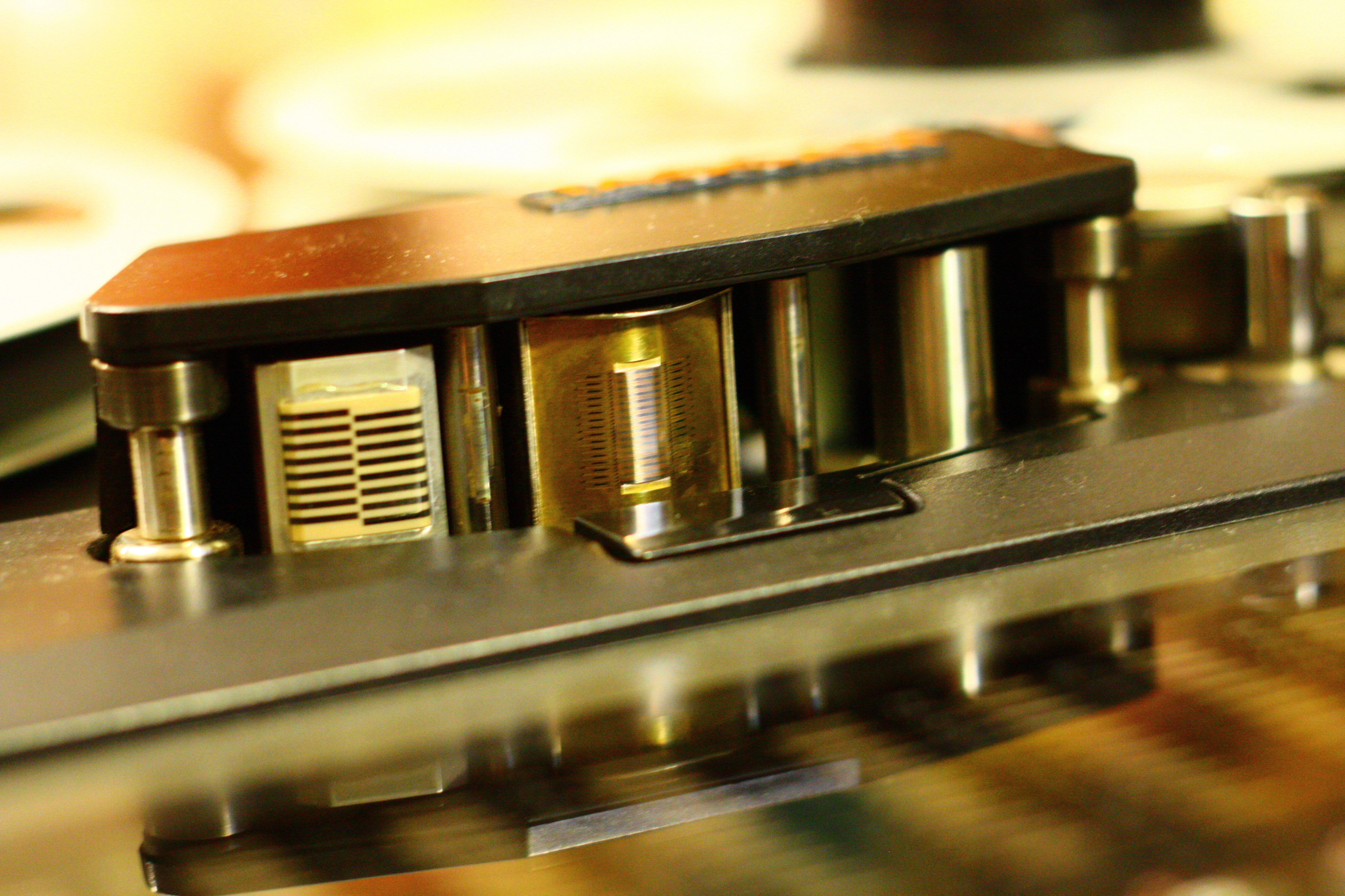

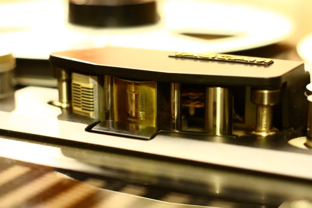

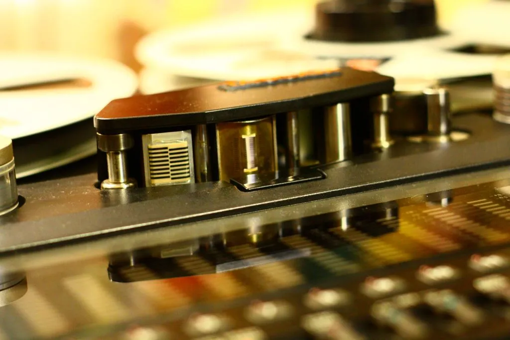

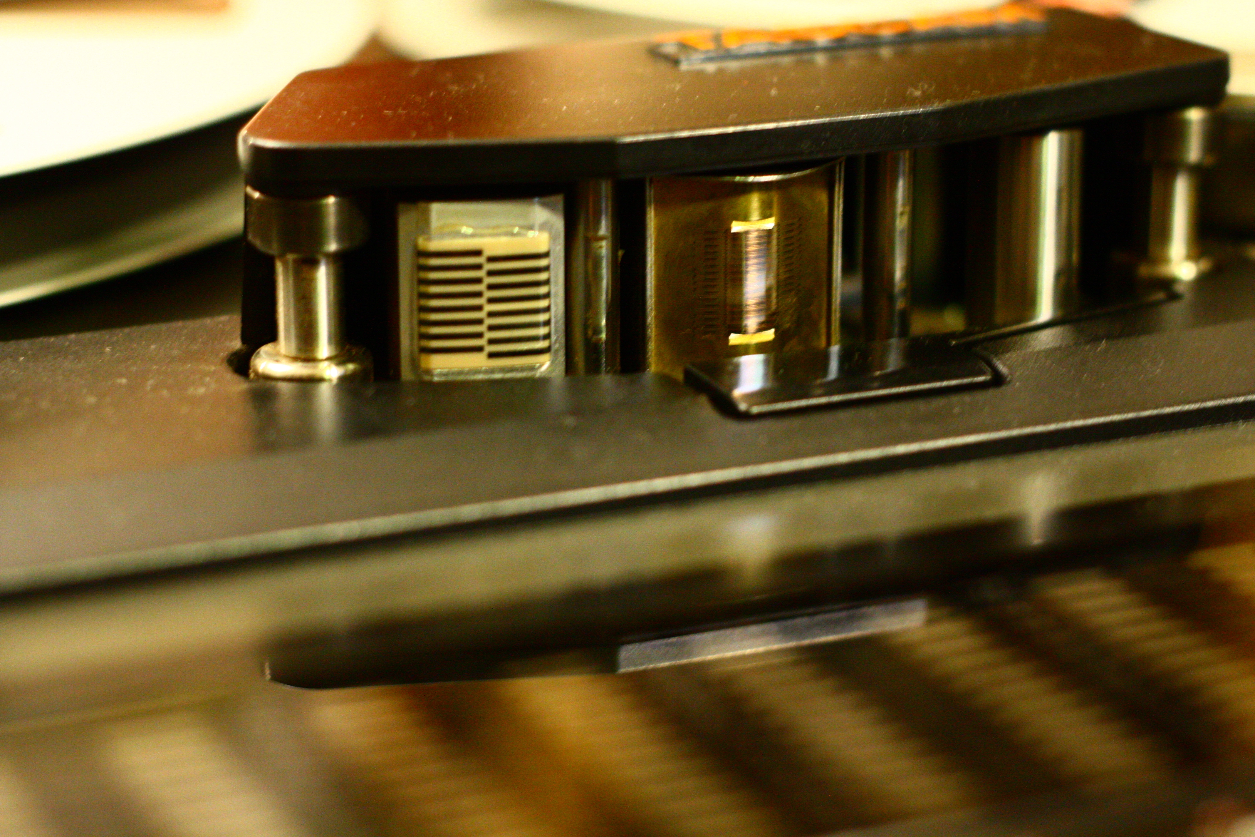

Heads condition

ok, the pictures are too far. need them closer, use a blank sheet of paper to control light reflection on the heads. Try the other steps that i listed earlier and make sure NR is always off. If the electronics are not calibrated properly the NR will create havoc.
Follow the steps and report results on all of them.

Anyhow, I checked the contact visualy, the head tape contact, and looks ok to me. However I noticed some scratches on the head out of the tape contact area.
