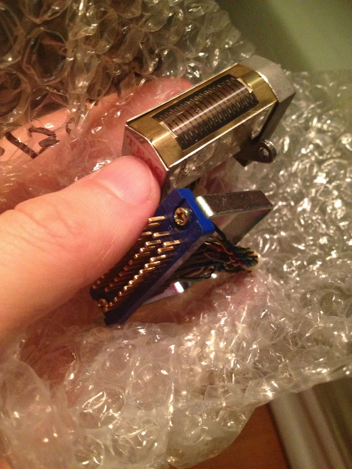

It seems to me, that if one is trying to plan for long term use of a tape recorder (say a five year plan) then some things become a priority. For instance, without access to a good tape supply, then the plan falls at the first hurdle. Next, must be quality heads. All the other things (mechanics and electronics) I'm sure with some ingenuity can be sorted out (albeit with a lot of time and knowledge). The first two though (tape and heads) seem like necessities.
I missed this auction in the States for a new MS16 head but have uploaded the photo to Flickr for anyone buying a 2nd hand machine, so they can compare a new head with whatever they find.
http://www.flickr.com/photos/33383402@N06/12465625035/
Al
hey, i missed the auction too. The head sold for $370 or something like that which is maybe still a good price for a new head like that.
Two things...
First of all, and no offense meant, but there is no way a picture of a new head can be utilized to compare to a worn head for any kind of assessment of wear/condition on the old head. A relapped head, if done right, will have the same profile and may look exactly (for all intents and purposes) like the new head. "My heads look awesome!" you might think as a result, when in fact they have less than 25% life remaining. Just sayin. Wear on lifters remain a great clue to a machine's mileage in my opinion, notwithstanding some machines may have had their lifters replaced or sleeved. YMMV.
The other thing to consider is this...how long do you think heads last and how much mileage per day/week are you putting on your machines? We all want to future-proof our machines, but I think, in general, we're all just a little too freaked out about heads wearing out faster than they really do. A friend of mine operates a busy well-known/respected analog to digital transfer business. He has machines that are running hours and hours per day most days of the week. He had a reality check when he sent a headblock in to JRF for relap. The block was off a machine that had been running 8 hours a day most days of the week for years. Block came back relapped with a head report showing 75% remaining. Something to think about. He said to me with my recreational use of my tape machines my heads should last a lifetime. Anyway, my 2p from somebody using their machines *constantly*. Most of us are not in that kind of business or running our machines near that hard.
I saw that auction when it was still going as well and made me wish I had the machine for it. Ended at $355 plus a fair shipping of only $5.00. They cost twice that in 1987. That was the deal of the decade! Well, if it works. The part numbers for the MS-16 and 85-16 record heads are different from each other and the base is different. So hopefully the buyer has an 85-16 or that part has become a replacement for the MS-16, or easily retrofitted. The one mistake the seller made was not listing the part number in the title or description. The more tech savvy of us search part numbers. It should have sold for much more. Great for the buyer though!
One thing a photo of a new head can do is show you how the original head should look. It can be hard to tell because while some heads are rounded like this one, others come to more of a point and appear flatter at the tip when brand new, leading some to believe they have more wear than they do.
This head is still available new from Tascam and I think is closer to three times this ending bid.

I think people tend to worry too much over the issue of "head life" in their analog machines. There are variables at work here, tape speed, formulation of the tape, machine set-up, amount of maintenance applied to the machine, etc.
I think it is sound advice to secure a spare set of heads or headstack for any machine you have. But dont go crazy, just keep up a slow methodical search. Sooner or later there they are at a price that doesnt break the bank. I hunted down and found at least a couple of NOS headstacks for each machine I own. They will outlast me by many years, LOL.
I cant speak too much to head life on consumer or "pro-sumer" decks, but a pro machine set up and maintained properly can run a set of heads for somewhere around 5000 hours (give or take). That is eight hours a day, five days a week for two and a half years. I dont think many in the home recording industry work their analog decks anywhere near that much.

I have certainly seen plenty of spent heads in my lifetime, but true it does take a long time. Pretty much the longer you've been recording the more likely you are to prepare for the eventuality of a worn out head or two. In fact I just bought a brand new Rec/Play head for my Tascam TSR-8 a couple days ago from Tascam, but it took 20 years for me to need it. And I can still probably have my current one relapped for a bit more life. No open gaps yet and sounds great. I just want to get heads now while they're still available, even though they seem to be more available like they've had enough demand to begin making them again. The price of the TSR-8/38/48 head is much less now than it was last year.
