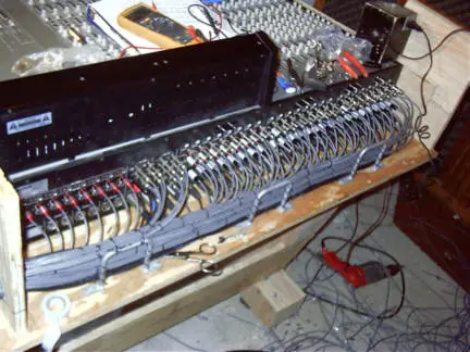

In any case I would strongly recommend a patchbay. RCA onboard connector can broke easily, so it is better to connect them once and for all to a patchbay.

You could make cables out of Neutrik connectors and good cable that is shielded but it would be a lot of trouble.
