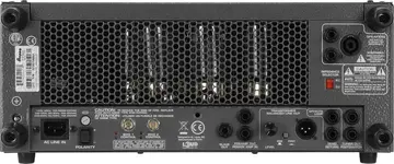

Made this a while ago, but bumping now because we didn't end up recording at the time. We are wanting to now though. How/where would I connect the Dp-02 to this amp and what cables would we need?
It is the SVT-2 non-pro (bottom pic), but the back connections look the same as this Pro I found on musicians friend (top pic). Can't link, but if you go to Musicians Friend website and search "ampeg-svt-2-pro-series-amp-head", you'll find it.
Again, we want to record while hearing it out of the amp.
I'm gonna suggest you really need to read up on this stuff since this is extremely basic.
On that amp though there are four potential places ..... the pre-amp out is obvious ..... and that's why i say you need to read up.
Even the most basic newb would know that the pre-amp out is a line signal and could go to the recorder.
You also have a balanced line out. How can you not see this?
Also the slave out would probably work though you want to do a search and make sure it's a line out and no, I won't do it for you.
And sometimes the effects loop can be used. But on this I'd go for the preamp out or the balanced line out..
Most guitar amps either have a send/return or a line out. Both are typically line level.
Most amps also will not route the signal through the send and return unless something is plugged into the return, so in other words you can normally go out from the send and as long as you don't plug anything into the return the signal won't be interrupted.
I think the DP02 will record 2 channels at once, if so go from the send(or line out) of one amp to input one, and from the send of the other amp to input 2. Just make sure to start with your DP-02 input trim turned way down and gradually increase it.
