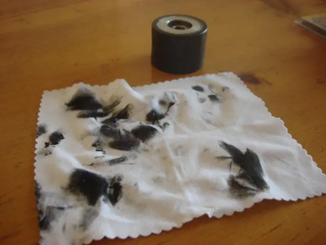

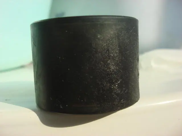

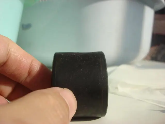

First i think is because i try a AMPEX 456 from a friend when i buy this machine.i fouud the problem of the sticky tape and
stop immediately,and rewind tape,it's very slow.after that i check pinch roll,it's seem ok,i clean it with water.then i buy MRL and run with no problem.and then some NOS AMPEX 407(now i don't think is NOS),and i find the problem!then i buy CAIKLEEN,i plan to clean the pinch roll,but now i see:the pinch roll sticky itself!
sorry my english,i want know is :first the sticky tape ,and then it's make the pinch roll sticky OR pinch roll sticky itself ?
i must buy a new one or somewhere can fix it.
