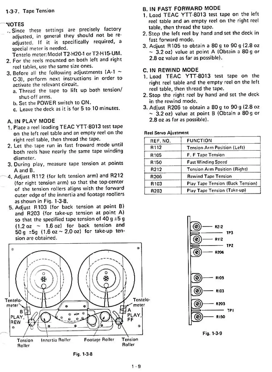

Your problem is on the tension adjustment. not properly set. Do you have a tentelometer ?. Follow instructions on section 1-9. see image attached.

Yes, you eyeball it vs. the tape tension rollers position.
The basic positional geometry looks fine, but one word of caution that may be relevant to your problem.
In the 388 manual the table denoting reel/servo adjustment pots,.... RW Tension (R206) and FF Tension (r105)are BACKWARD. A MISPRINT.
So, when you think you're adjusting FF tension, you're actually adjusting RW Tension, and vice versa.
This took me hours of T&E to determine. I even pencilled in the correct pot #'s in one of my manuals, but apparently not every copy. If you're adjusting FF when you think it's RW, and RW when you think it's FF, you'll basically never get it right. Take that from experience.
I think from the looks of your video you have things set up ok in a basic sense, and your problem can be adjusted out with more effort.
SO, CORRECT ME IF I'M WRONG, BUT
FF Tension = R206
RW Tension = R105
I'm going off memory, guys, but it's a pretty vivid memory when I discovered this pertinent misprint. Tascam manuals aren't prone to misprints, but this one got out there. If I could find my second copy of the manual, would show where I pencilled in the corrections. For now, just going off memory and intuition. Ok.

Looking at the video again, I don't think the tension rollers are in the right positions, geometrically. Look at the manual diagram, or picture it if you will:
As far as correct tensioning without at tentelometer, the position of the tension rollers tell the story. The CENTERS of the R. and L. tension rollers should intersect with an imaginary line that's drawn across the BOTTOMS of the tach roller and idler roller, respectively. (SEE FIG 1-3-8, above). That, of course, is when Play motion is moving tape forward. That's the basic geometry that will give you proper tension. Set those and then get back to the FF/RW issue afterward.
I still believe your issues can be adjusted out.
:spank::eek:;)
when doing this adjustments make sure to advance the tape to the middle of the reel too. As suggested above that imaginary straight line in the center can get you there

Its not primarily a tension problem . Use R112 and R212 to move the servo arms up to about the midpoint. Use a plastic (not metal) screrw driver/trimmer. The clue for me was it ran at speed when you pushed the servo arm down. The arms should be near centered in the slots

I'm not sure if I can answer your question directly, or even if I've mentioned this above in this thread, but something to beware of is the FF and RW pot controls are mislabelled in the manual. I discovered this mostly by T & E, and maybe contributing to you imbalance problem. (206/R105). I can't find my other copy of the 388 manual to verify, but I'm sure I've run into this issue.
