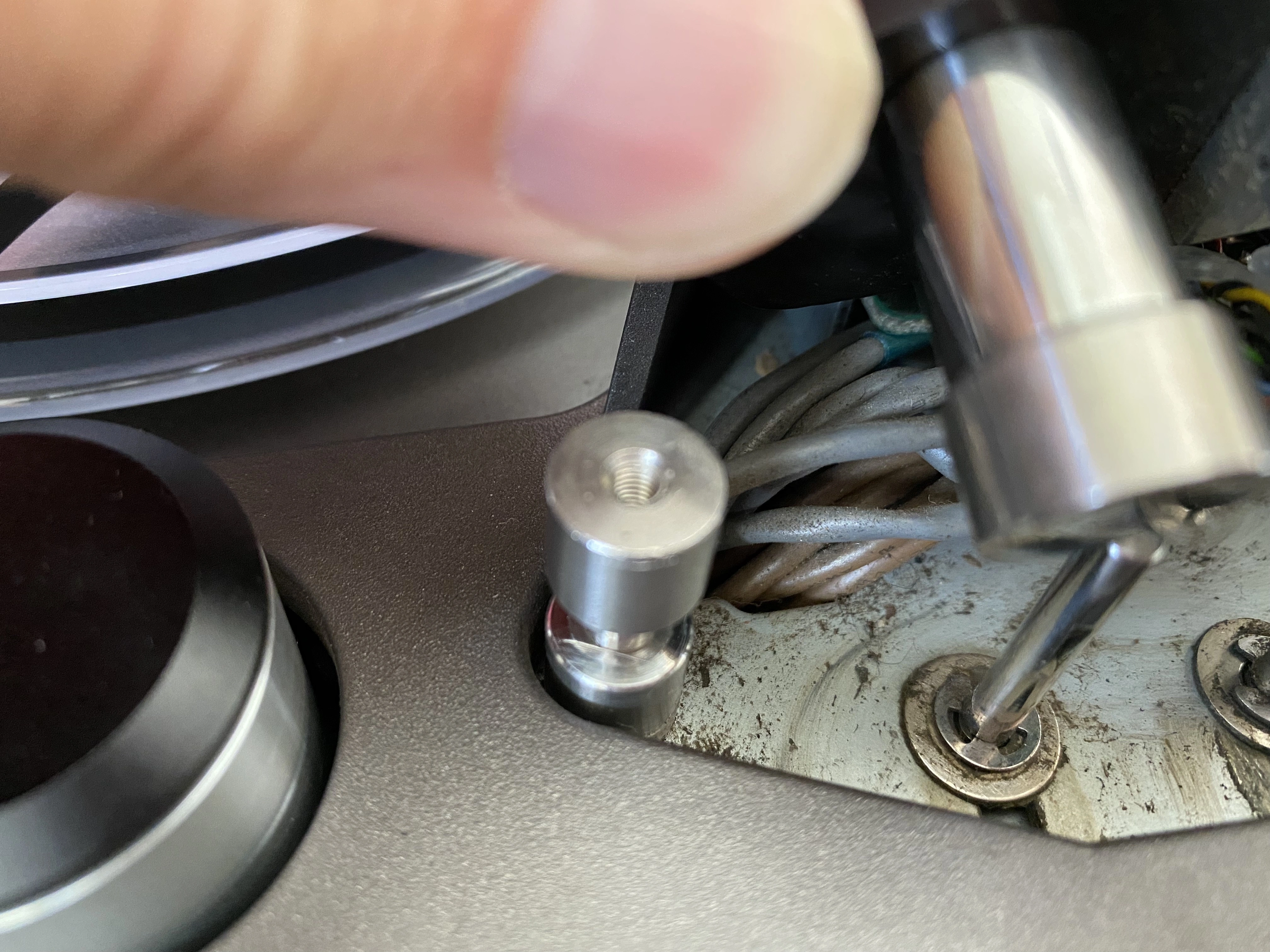

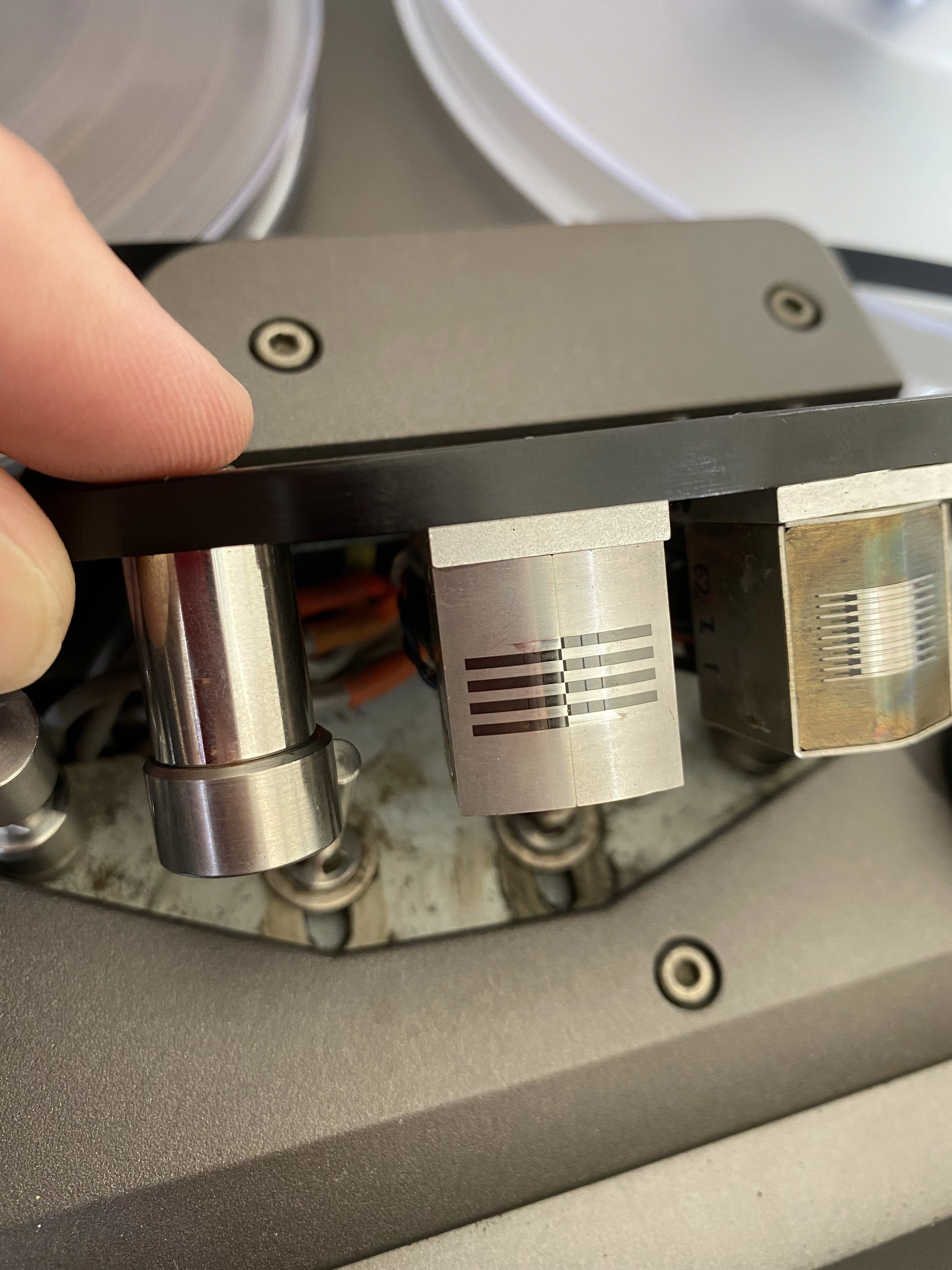

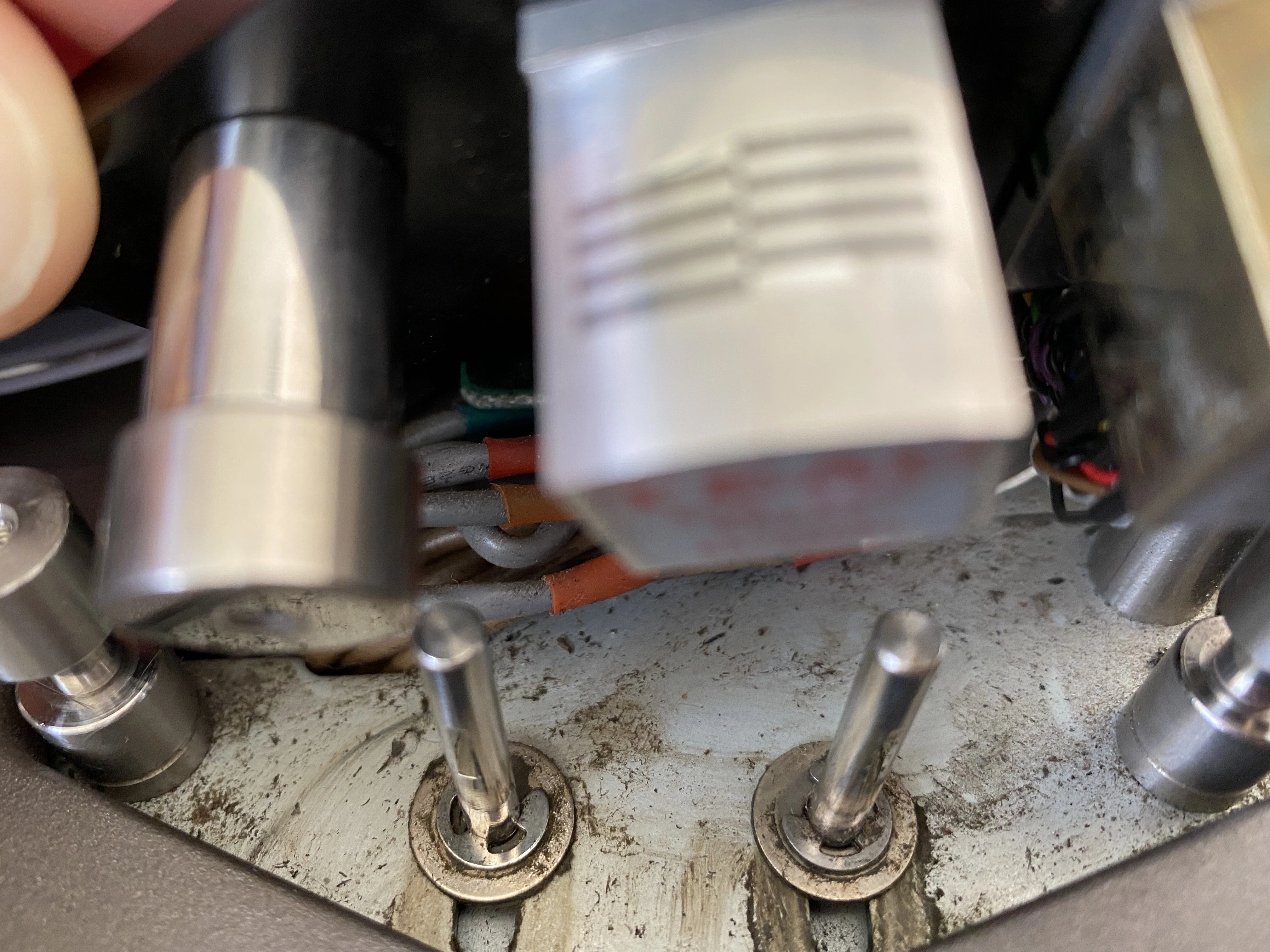

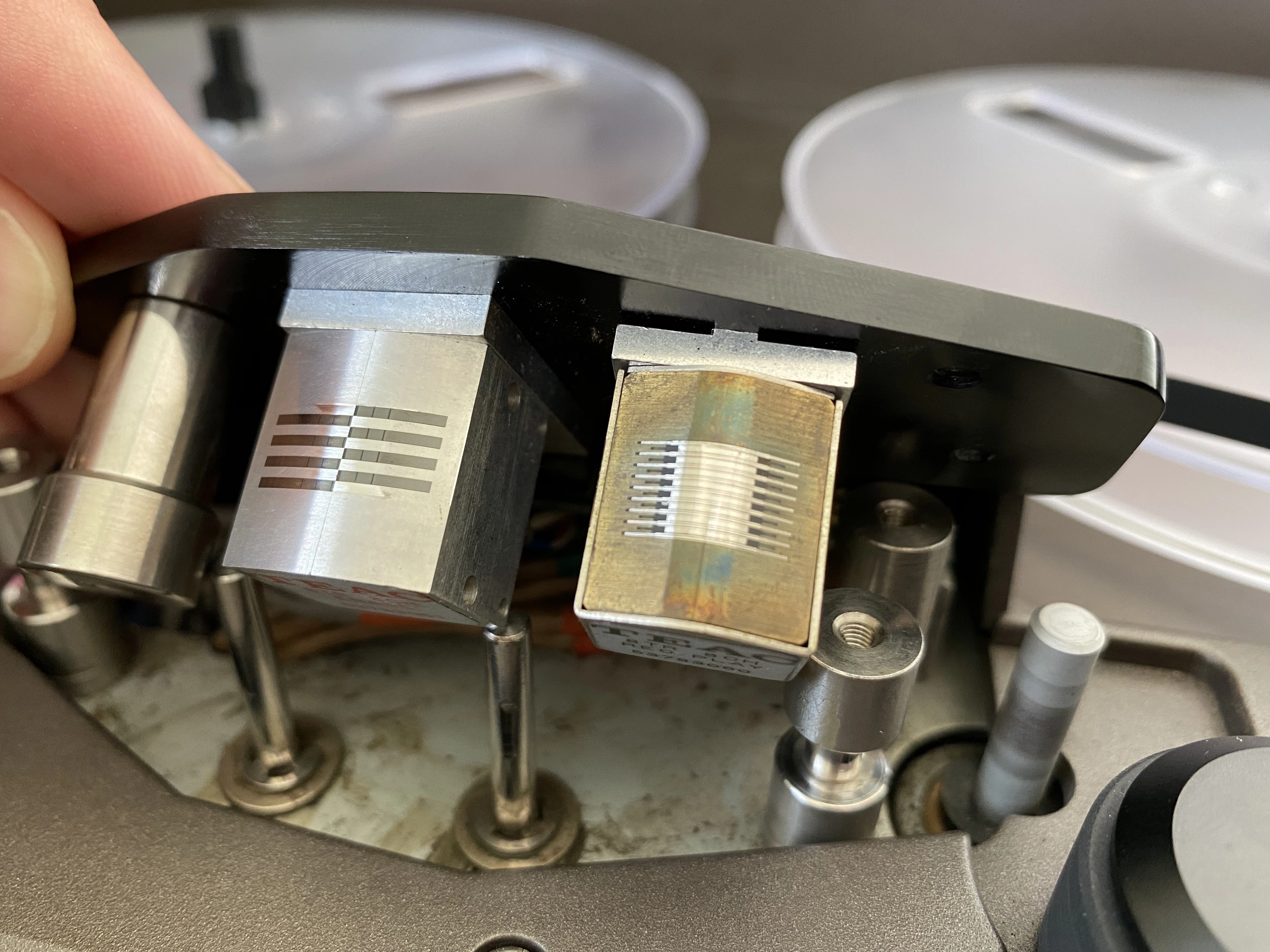

Here are some pics of the tape heads and path.
@sweetbeats yes, it is resolved after running the tape path in FF and Rewind with the lifters defeated (tape directly on heads). There was less and less shed each run thru, ultimately bring back my tracks 1 and 8 to fully clear sounding!
I guess my question now, will i have to do this every time I use a new reel of ATR tape??
View attachment 111248View attachment 111251View attachment 111254View attachment 111257
Well it’s hard to tell what the wear path looks like on the record/play head from the pics. You included more pics of the erase head than the record/play head. From what I can see it looks like nominal wear but I’m not really sure. A picture looking across the laminations with better light, like with a flashlight shining on the face of the head and then the head laying more flat so I’m looking across the wear path like looking across a valley so I can see the relief of the wear path is what I’m looking for. I’m not saying you have to go to that trouble, I’m just letting you know what I’m looking for.
As far as whether you’ll need to do this every time? I have no idea. You’ll know if you’ll have to keep doing it the next time you put a fresh reel of tape on. We don’t know if it’s working better because the wear path is relieved, or the tape is now worn at the edges. If you have a fresh reel you could put it on and see, and if you are back to square one you’ll know it’s the tape that’s getting worn. It’s safe to say over time this will get better, but how long it will take us anybody’s guess. OR maybe you put that fresh reel on and it’s much better. Again, a relap is the only way to properly fix the problem, and I highly encourage relief slots be cut if you have that done.
Are you using MDS-36 tape?
