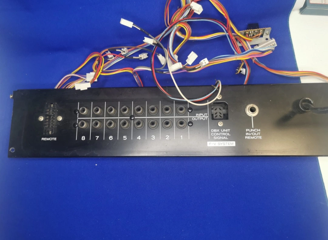

From memory of my 38 days, the connections on the 38 are all RCA IN/OUTs - a pair for each track. I used mine with a Fostex 450 Mixer (no tape deck) which had 8 matching sets of RCA IN/OUTs. This SSL Big Six doesn't seem to accommodate the 38's connection requirements. There are lots of inserts though, and individual channel compressors.
Here's the 38's rear panel connections :
Here's a 450 Mixer like my old one. Notice the RCA Tape In/OUTs at the top of each channel - very handy for a 38.
