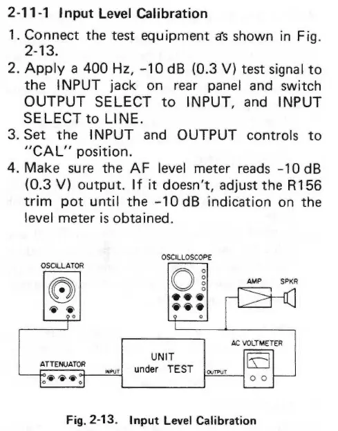

I will be doing both mechanical and electrical calibration. I agree that the electronics are mostly shared between the models, but I seems to recall having read somewhere that the 34b is a newer, modified 34. Can't find the site now, though.
The reason I suspect that the procedure is not the same as for instance the 34, is because the 34b has input and output level controls on the front for each channel, *with* a 'cal' position (with click). The Tascam 34 is straight line level I/O. So I suspect (from the procedure from other teac/tascam models I've calibrated) that there will be steps where you might want to have to put the controls in that 'cal' position, or another step where you put them fully clockwise. The 34 obviously won't have that step.
I really hate having ambiguities in service manuals :facepalm:

do it with CAL enabled. so it ignores the knobs. I have a tascam 42 that also has CAL switches and all of the calibration is with the CAL switches enabled. So it should be the same, and ideally you want to use it in CAL mode as well.

It doesn't have a CAL switch, CAL is just a position on the dial, with a click.
I probably will have to calibrate this deck 'in the spirit of those other servicemanuals', instead of trying to follow it to the letter.

Found the correct manual,
and the cal setting :D
Thanks for al the help.
