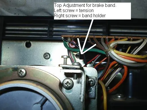

First image :-
This image shows the top end of the brake drum and band assembly. There are 2 screws on top. The right hand screw holds the band in place and the left hand screw adjusts the slack in the band when the solenoid engages.
Hope this info helps
Keith

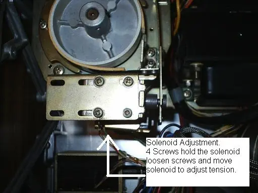

Second Image :-
This image shows the solenoid and the 4 mounting screws. If you loosen these 4 screw you can then slide the solenoid either left or right to adjust the tension on the band from here. If when the solenoid engages you hear the solenoid buzzing loudly then that means the bolt isn't sliding back far enough and the coil will begin to heat up which could burn out the solenoid, so you must take care when making adjustments here.
Keith

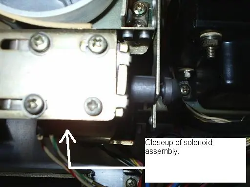

Third image.
This is a closeup of the solenoid so you can see the bolt and the band holder on the end.
Keith
