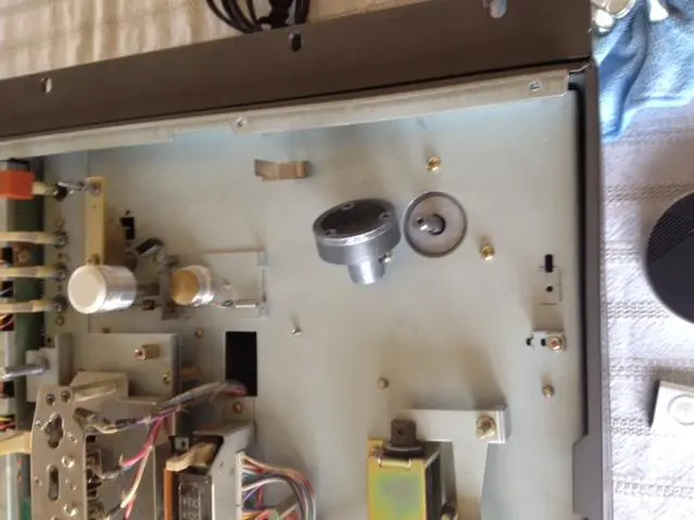

Hi, i am trying to setup my Tascam 32. There is tape rubbing and a visible wobbling on the left reel. Not sure if this can be fixe only with height adjustment. Apparently the motor shaft is not bent. So there are five screws on the tascam 32 reel table; 2 that are perpendicular to the shaft, the ones the manual says to use for heigh adjustment, and there's the three on the surface of the reel table. So i remove all of them and the reel table won't come out. It is loose i can vary the height, but there is something blocking the extraction. So if anybody is familiar with this machine. i will appreciate your help, so my questions are:
1. Is this wobbling fixable ? or do i need to replace the reel table. The shaft is not bent (motor shaft)
2. How do i remove the reel table ? do i gain any thing by doing so ? to check if it is bent or not ?
thanks,

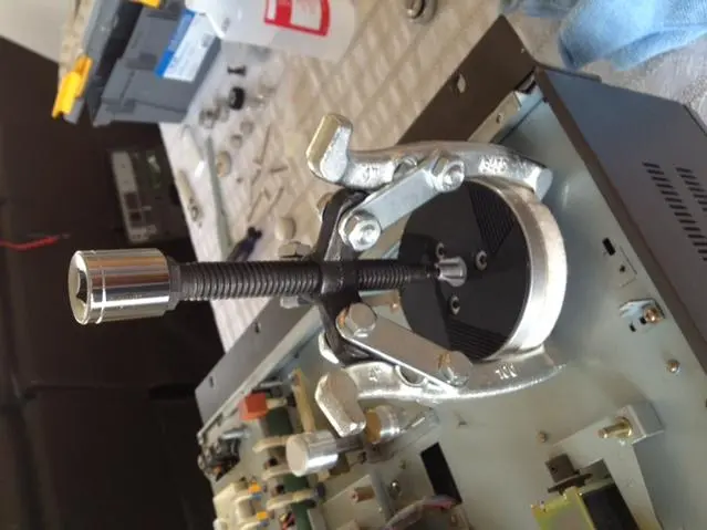

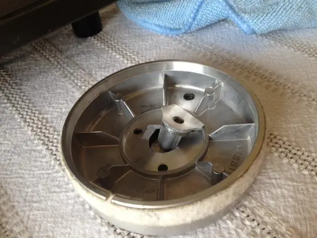

broke the table
Hi, so i went and got a gear puller and tried to remove the reel table and the thing broke :(. see pictures. Where do i find a replacement part. Nothing on ebay, ay other ideas ?

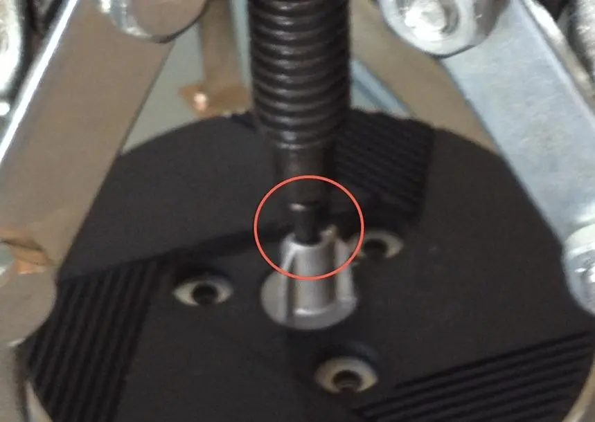

I may have some, I will look. I can see how the hub fit tight in the reel table, do you see the scoring/line where it was forced? That looks like the right puller, I put a screw in the reel table first for the center of the pulley puller to seat on. The way you have it the center part is pushing on the reel table and the 3 forks are pulling on it, you need to have the center part pushing on the motor shaft. I put in a screw in the hole but it wasnt threaded to the reel table, it just went in loose and seated on the motor shaft to provide the anchor point for the pulley puller. Well now you will know when it come time to fix the wobbly TSR-8 reel table. What are the numbers on your reel table?

yes, i know what you mean with the center and pull from by having support ob the shaft. That is exactly what i did, i used a long allen screw so it goes inside all the way until stopping in the shaft at the bottom of the hole. Used a lightly thinner screw so it doesn't get tangled in the thread. see attached zoomed in picture, where you can see it, it is the same color as the puller that's why it's hard to see on the original picture. So now i am afraid the TSR-8 may follow the same fate if i try this. Any other ideas that may avoid this situation ?

Oh I see, good thinking. So it broke because it was jammed on the hub so tight. I dont know why they continued to allow this to happen, They must have known they were jammimg the reel table on. I am pretty sure I have a reel table. I have to check when I go out to the studio today.

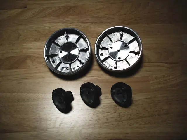

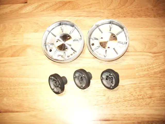

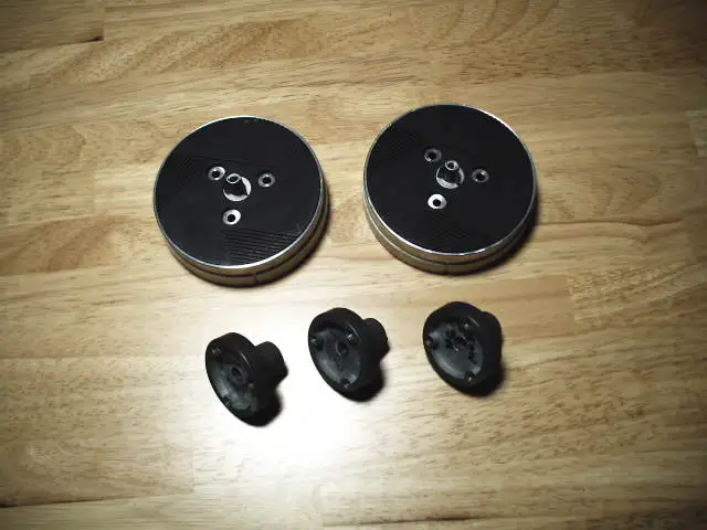

I found these 2, I have to see if they are spares or not. I have a friend on e-bay who might have some also.
VP
VP
Thanks, can you sell those to me ? would like to get two assuming it can be adapted also for the TSR-8. Can you PM details ? price + shipping ? or also your ebay friend. thanks a lot
