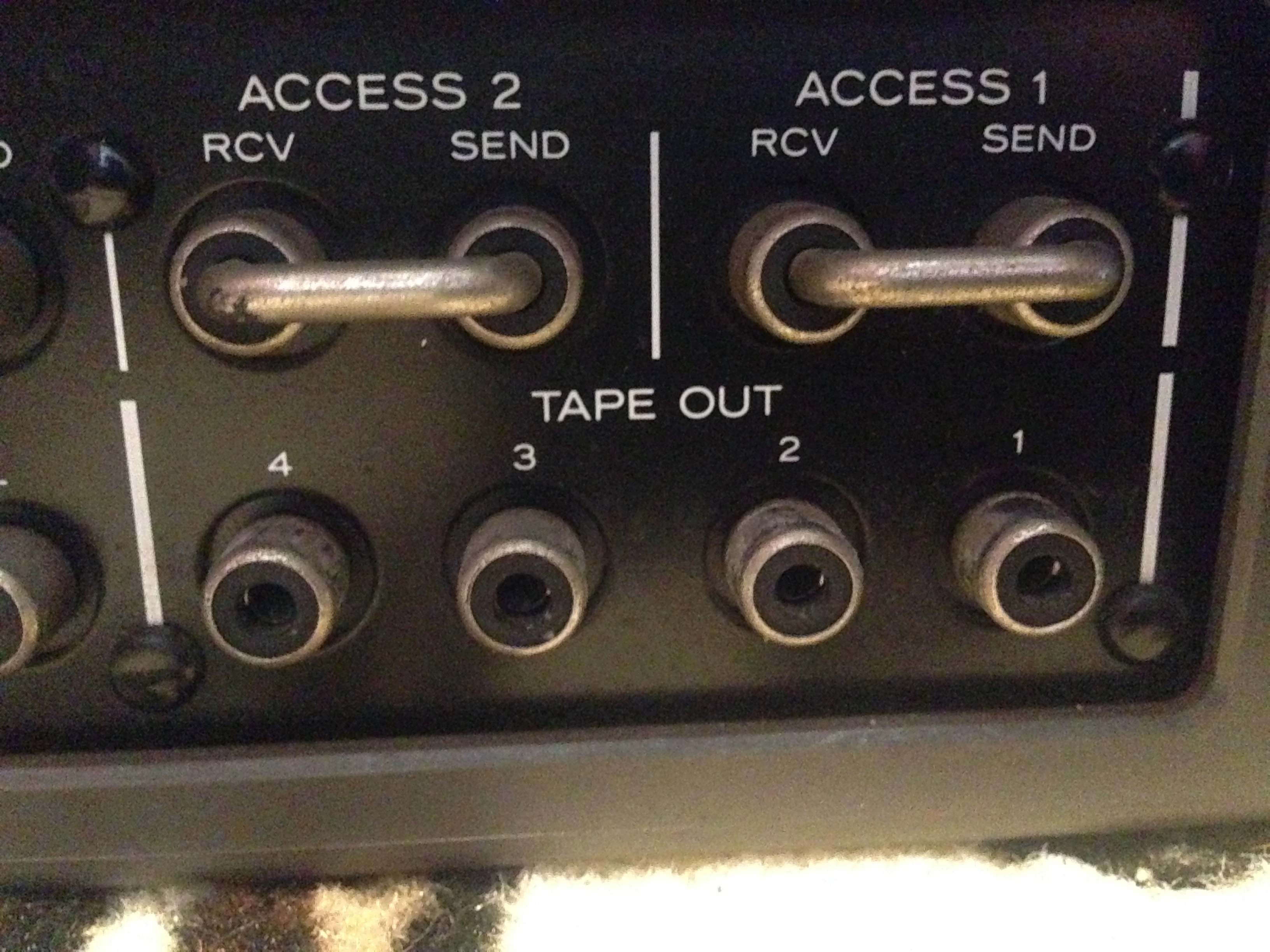

I have a Tascam four track cassette recorder. I figured how to dump a whole mixed stereo song to the computer, but now I want to try dumping all four individual tracks simultaneously so I have more options for mixing in Logic. The cassette machine has separate RCA outputs for each track. There's a picture of what it looks like. My recording interface has 1/4 inch inputs.
I want to make sure I buy the right kind of cables. Is this what I would need, four of them?

Yep, that'll do it. Have fun! :)
Thanks! I have a couple RCA cables that are the regular split ones with red and white ends. Can I use two pairs of those and four rca to quarter inch adapters instead?
Thanks! Last question, do I need balanced or unbalanced? Sorry I'm not sure exactly what the difference is.
The 244 is unbalanced out.
Your interface should accept balanced or unbalanced. You are doing very short cable runs, so you shouldnt need more than 3 feet, therefor unbalanced wont be an issue.
