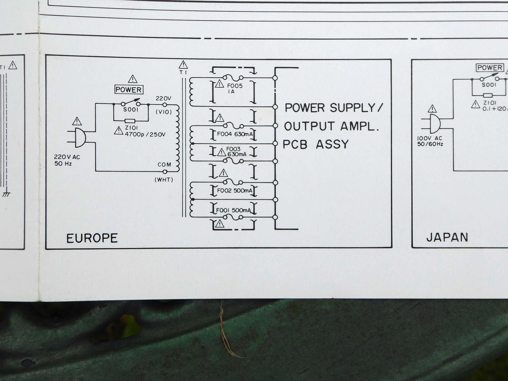

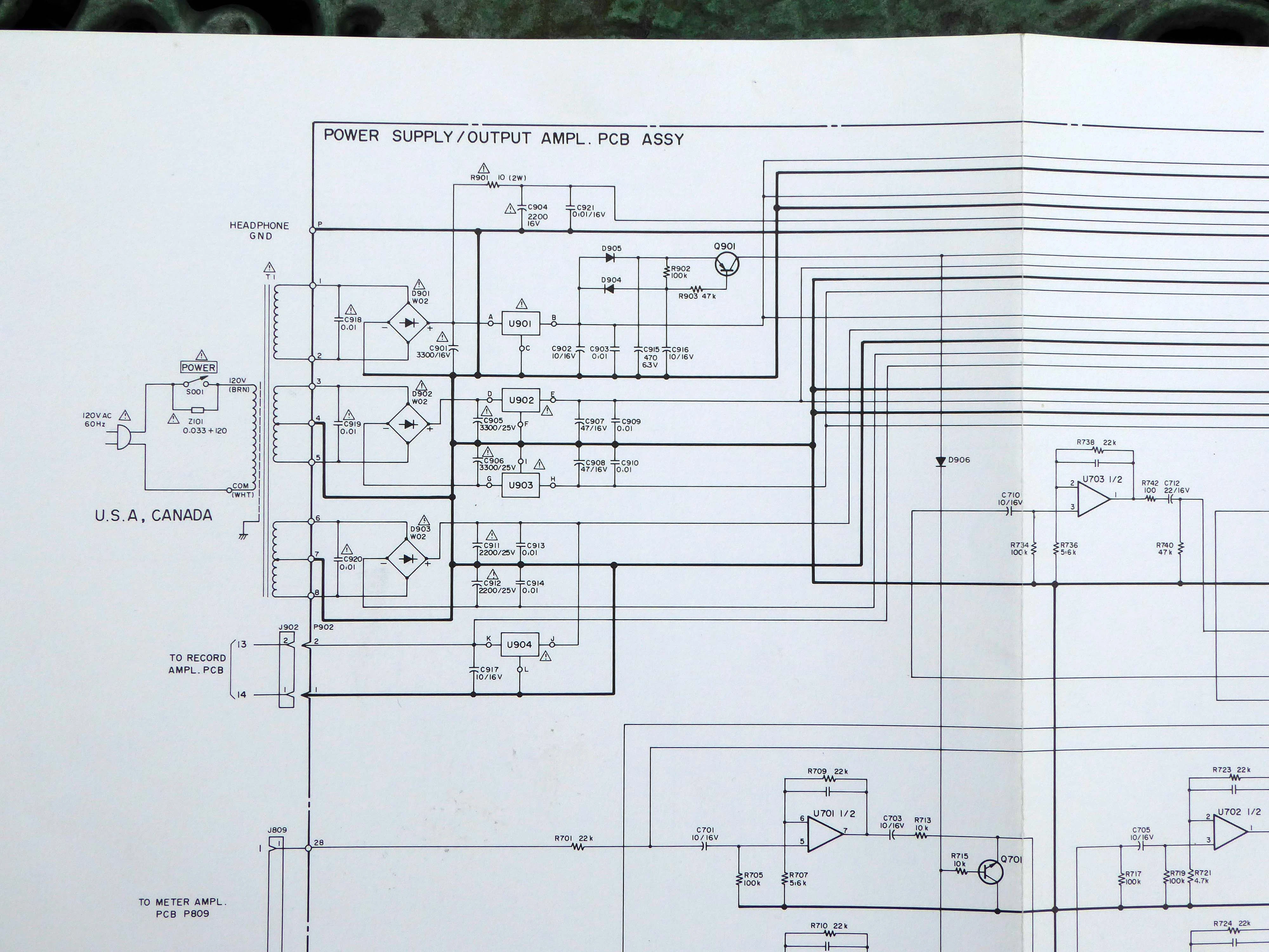

JP - I'm beginning to panic a bit! I put 2 quick blow 500mA fuses in and switched on. There was a bit of a longer delay than normal I think before the sound came back but it did! Everything worked perfectly. I then switched off to put the back on 244PowerSupplyAdd.webp244PowerSupply.webpand screw it up. Switched back on and no sound! Fuses had blown again, I replaced them and everything was fine. Used the machine for about an hour. Switched off, left for a few minutes and switched back on. Worked fine. Left it half an hour and switched back on and the fuses blew again - no sound. I found the schematic which I've attached. Interestingly the US version doesn't seem to have these fuses (have you seen any in yours FB?), only the European one on connections 6 and 8. I'm not too good at this but wonder if there is a leaky capacitor? C920 across the rectifier and connections 6 and 8 is a 250V 0.01 microfarad metallised. There is a fair bit of hum in the 'phones, which maybe indicates some leaky caps somewhere. Had this for a while though.
PS sorry if the images look a bit strange - haven't posted any here before...

Thanks jp. I'll try to psyche up to do that. Maybe I ought to buy a load of fuses on eBay - they are 25p a pop from Maplin and I might need 100s! Just one other thought - I wonder if that rectifier after the fuses is shorting? I guess I should be able to poke about a bit with a multimeter but I find that schematic a bit difficult.

PS I still wonder if the USA versions have the fuses. Appreciate it if you guys take a look sometime. The manual seems to indicate they are only fitted for 244s sold in Europe.

Thanks jp and FB. Day two and it is still working! A bit concerned about any possible damage though.... I'm still wondering why fuses aren't fitted in the US versions of the 244 and wonder if anyone can confirm this?
