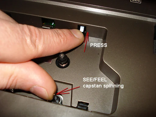

power it up.
open the casstte door.
then press (gently) on the switch as shown on the attached photo.
when you press on the switch the capstan should start spinning, it may be hard to see, but you can touch/feel it.
If it does not start spinning but you hear motor sound then I'd guess that the capstan belt either off either is broken. You'd need to open bottom cover and see what's going on.
Could be something else? - I don't know.
here's photo
