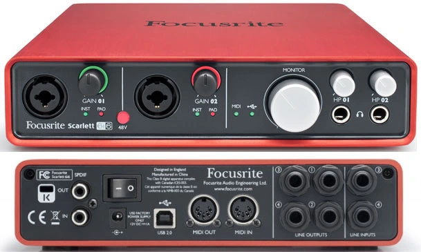

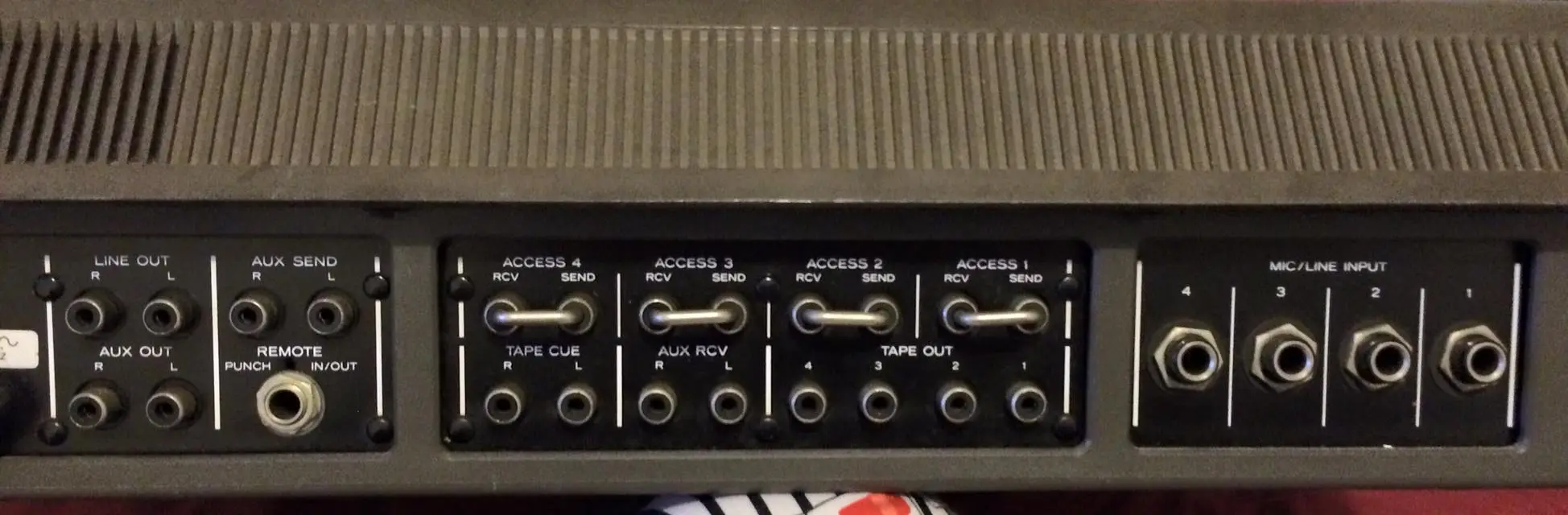

I'm a total noob and grabbed myself a second hand tascam 244. I would like to record stuff from ableton into tape and then back record it back into ableton.
Anybody know the correct cables and routing to achieve this?
Sorry for being so newbie!
Attached are photos of the ins and out(puts) of both hardware devices

Grab an stereo RCA>1/4" cord and go from the specific track (only connecting one of the RCA's) right into the Focusrite (switched to LINE) or hook both the left and right RCA's up to the LINE OUT and run that into the Focusrite the same way.

If you're doing a stereo track, just run 1/4" cables from outputs 3 and 4 of your Scarlett to inputs 1 and 2 of the 244. Then use an RCA cord with RCA-to-1/4" adapters to get back to the CPU. Plug the RCA end into the LINE OUT L/R of the 244. (You could also use the TAPE OUT 1 and 2 jacks if you didn't want to EQ the tracks or anything on the 244.) Plug the 1/4" ends into inputs 3 and 4 on the Scarlett. That'll do it!
