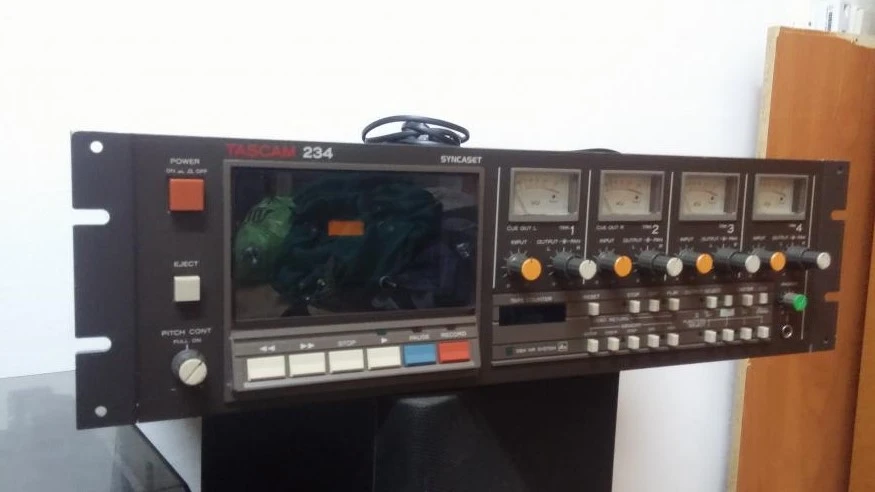

My tascam 234 i got on ebay finally arrived today.
Im a bit confused about it after testing it..iv'e got a few tapes i have recorded on my akai mg614 (on double speed). And as far as i know the 234 runs on double speed only.. it seems that the tascam plays it on regular speed :confused: .some cassette albums ive got it plays fine..which is clearly not suppose to.
The same exact tapes ive recorded, were tested a few weeks ago on a friend's 234..and it played just fine.
i can say from my humble experience that it looks like a good, refurbished to some degree unit (after seeing 4 different tascam 234 units and not buying them because of poor condition) and the speed issue, as far as i can say, is not due worn parts (worn belts, anyway). also it runs smoothly at accurate normal speed.
what makes me come to the conclusion that this dude i got it from on Ebay, or a previous owner, deliberatley 'moded' this unit to run at normal speed.
the question is wether re-changing the speed to it's original 3-3/4 rate, requires any 'critical' work or change of parts, or is it comes down to some internal pots?
cheers

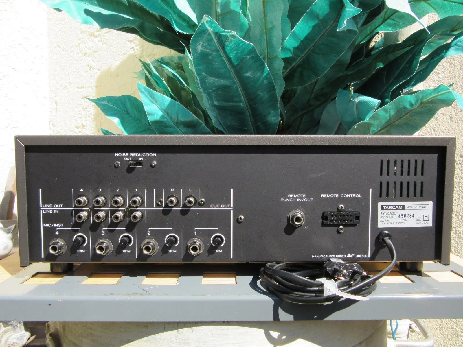

well, mistery solved, i got the 234L model. zero info on that sub-model tho
do you think a mod to run it at double speed is possible?
worth the hassle?

Wow...interesting. If I get a chance I'll see if I can identify anything from the bits I still have left from my parts 234, or from the technical documents.
I never knew there was a 234L.
Interesting!
