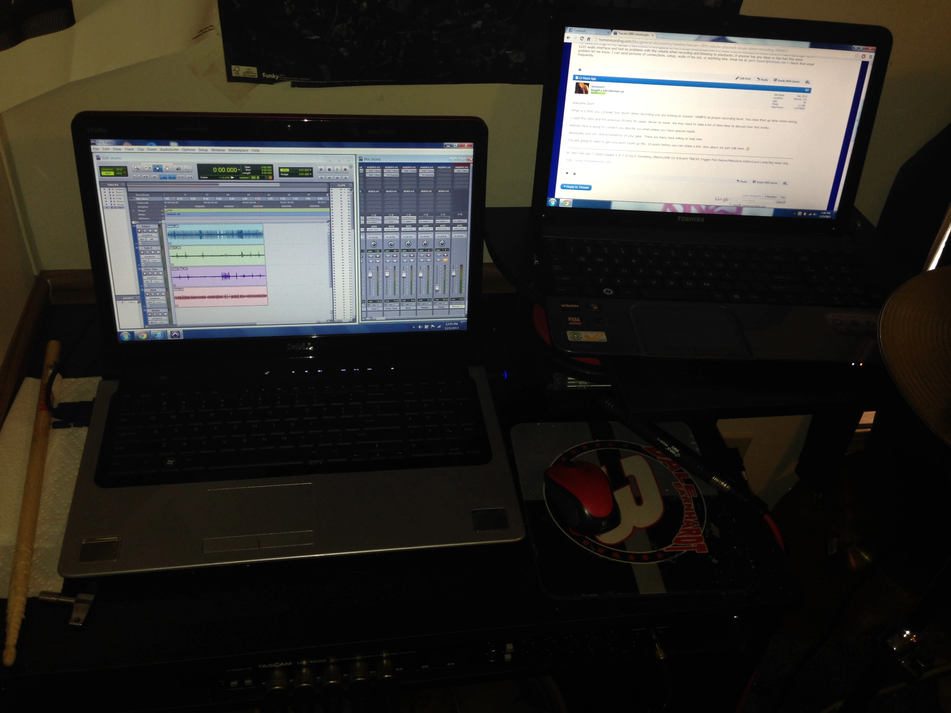

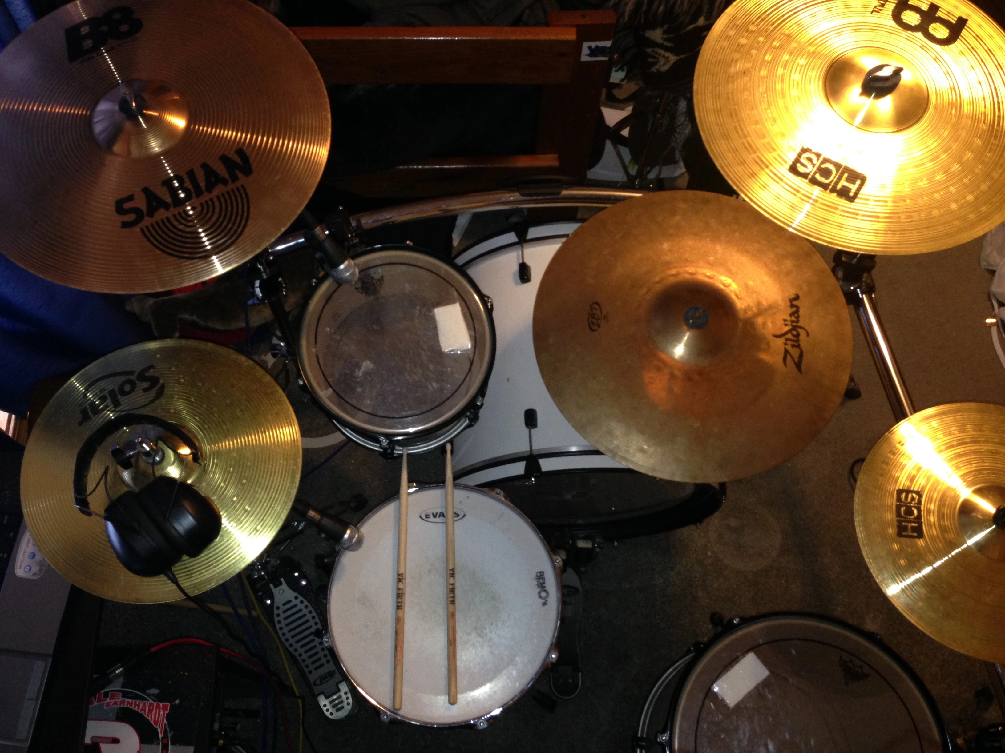

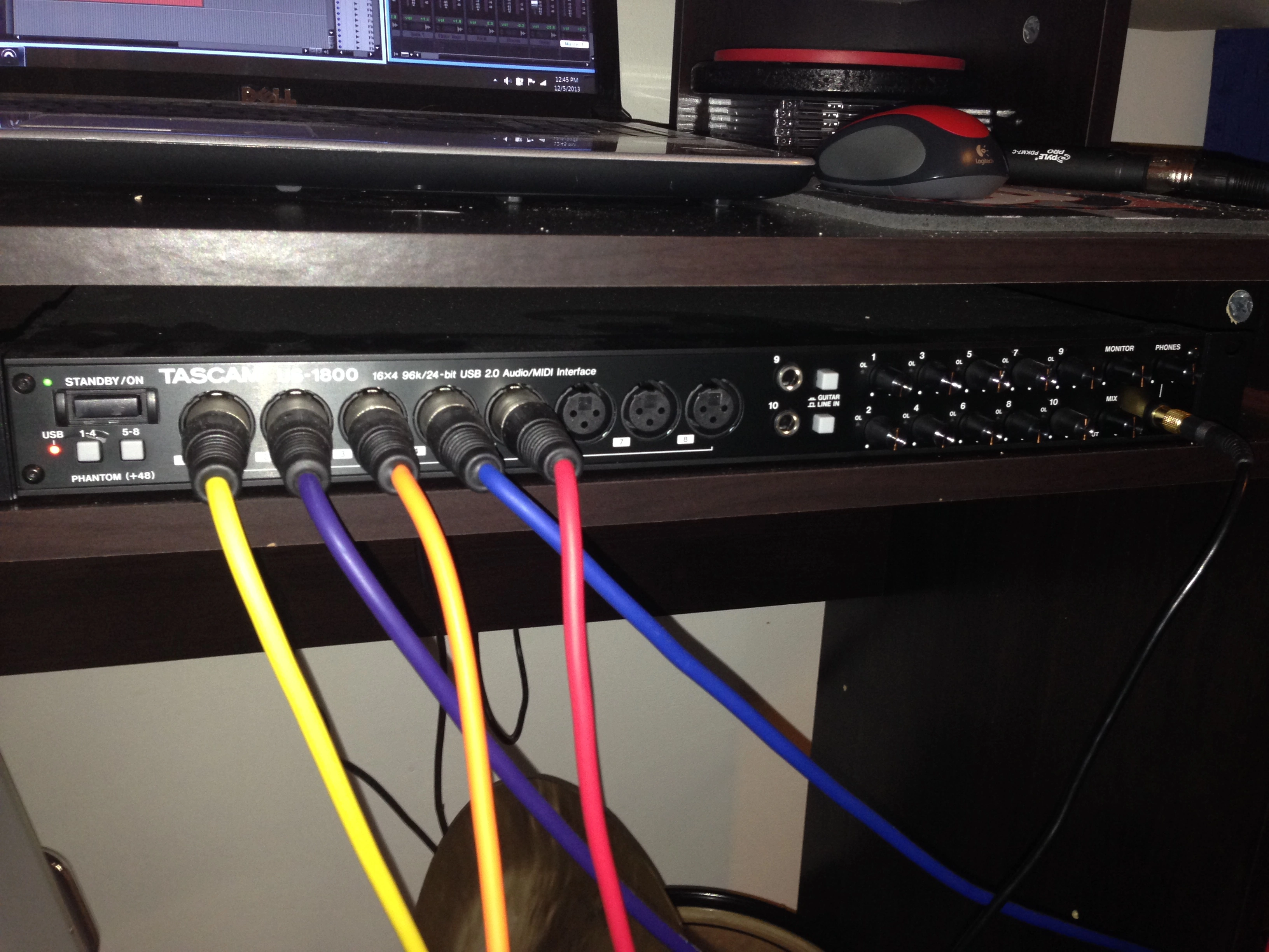

Jimmy69 I mean low as in when I go and listen to the playback and loop it over a song that I am covering I have to crank the volume up on my headphones and computer and interface to get a decent sound. And here are some images of my setup. photo 1.webpphoto 2.webpphoto 3.webpphoto 4.webp
Try turning your mix knob on your interface during play back , you probably have it turned the wrong way.
Zach: from the pictures of your pro tools tracks the wave forms looks like you are getting a solid amount of gain. Cranking the headphone volume is definitely not a problem. Recordings are not going to be as loud as a commercial mix until the mastering phase. Also I have noticed the US-1800 doesnt have the worlds loudest headphone amp. I was just playing my bass into a us-1800 with sennheiser HD280's and I had the volume all the way up.
+1 I use a 1800. Playing back tracks weve recorded while I listen on the headphones to add drum tracks is not enough volume. I bought a headphone amp and problem solved.
