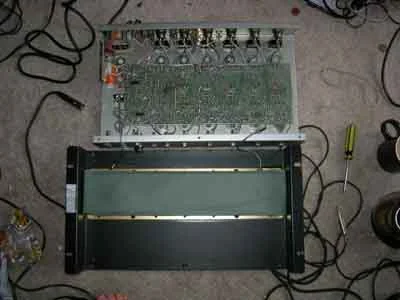

i've been experimenting with some DIY spring reverb configurations using accutonics tanks and have picked up a couple old reverb mixers to have something to compare with sonically, experiment with swapping tanks etc.- and also hopefully to have the option to use one of the mixers as stand alone effects in a loop on another mixer.
this tapco came in last night - i like the sound, its an accutonics type 4 tank (4 springs[2 parallel lines with 2 springs each]. looks like a fairly simple design inside - and with a funny (unique to me anyway) effects loop/reverb section that allows you to use the single effects loop for either your own outboard FX or the built in spring reverb, or any balance of both signals - interesting use of economy... its mono.
well, my main thought now is if i can tap a signal somewhere to give me the 100% wet signal from the reverb (after its been preamped back into a line level signal - preferably after the verb 'contour' as well) - this so to use as fx in a loop on another mixer without having the original signal mixed in. I'm willing also to permanently modify 1 or 2 channels if necessary (for instance if it is possible to cut the signal from the channel to the main out while yet still giving the channel signal to the verb), though i imagine that it'd be easier if i could just tap the reverb signal after its been reamplified and before its mixed into the main output.
anyone here have experience with these or similar mixers to give me some hints? or is there something I'm missing about this mixer that would allow me an all wet signal without mod'ing?
and last, i'm open to any discussion/suggestions on this mixer and spring reverbs in general, how they're usually wired up on the inside in these old mixers etc.
the manual seems to be pretty in depth with schematics. (schematics are still rather more difficult for me to read than French unfortunately, and i couldn't quite get a grip even from the block diagram for a clue as to where i might be able to tap the verb signal from)

I'm reviving because this is an easy mod, and I kept coming accross this thread looking for info on it. Basically just follow the main bus and scratch out the trace just before the effect loop gets added to the bus.
Find C26. The solder point before that is the effects joining the bus.
This takes all input channels out of the mains, but I'm modding the 1/4" input into a post eq/fader output. This is easily done from the center tap of the treble pot.
I thought about having ch.6 be the sole input to the verb, but I'm going to live with all channels being able to drive it at the moment.
