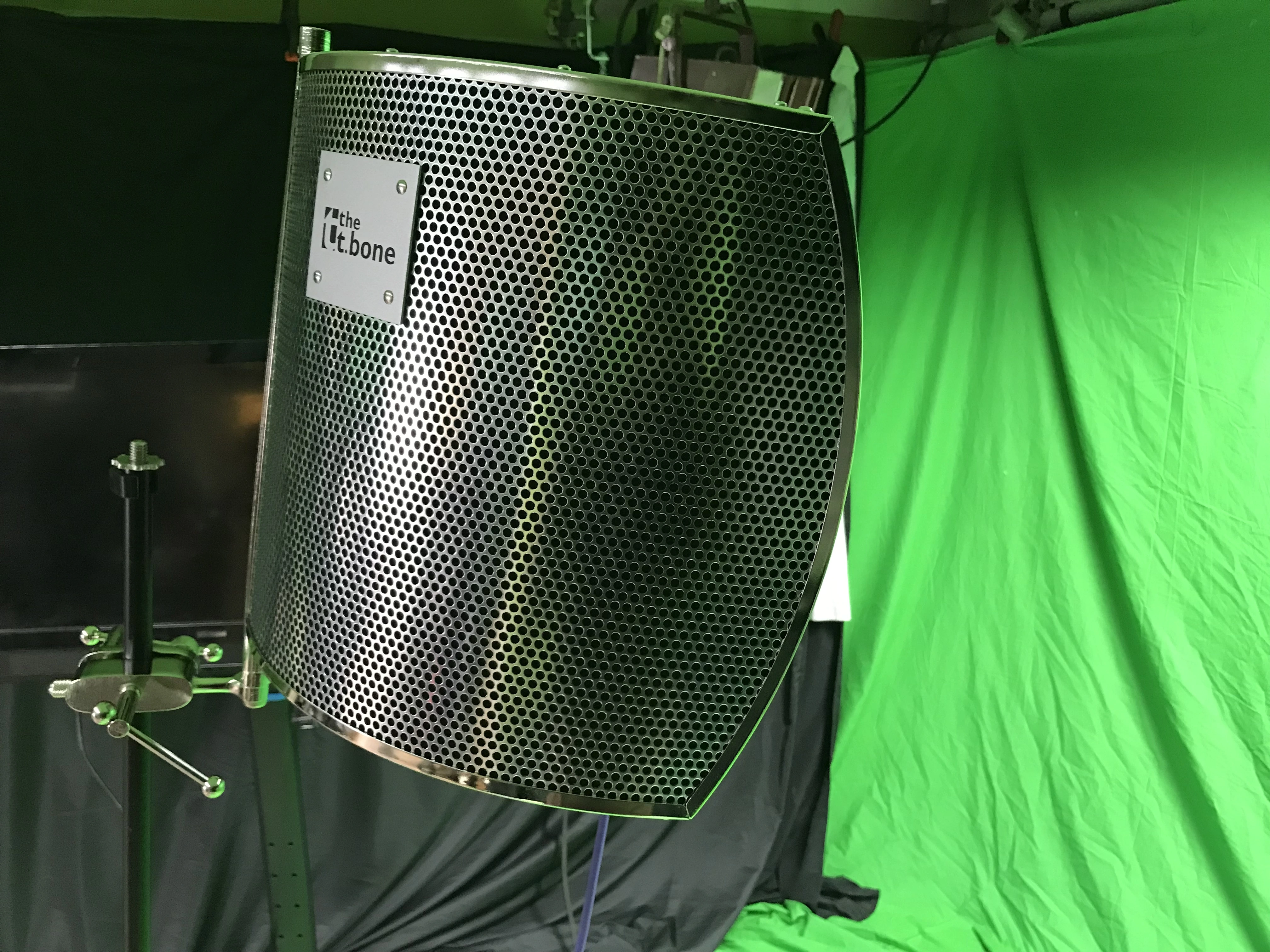

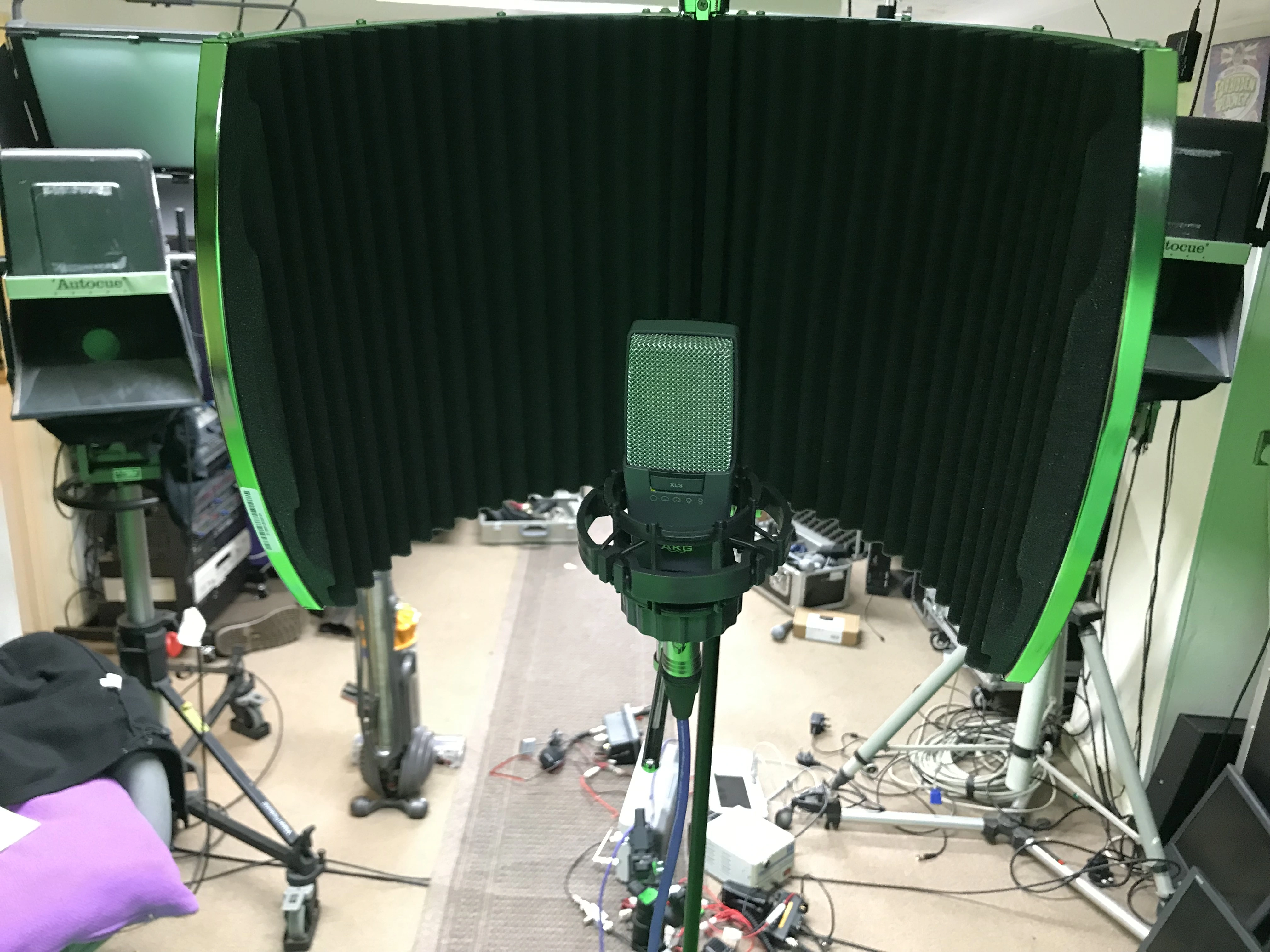

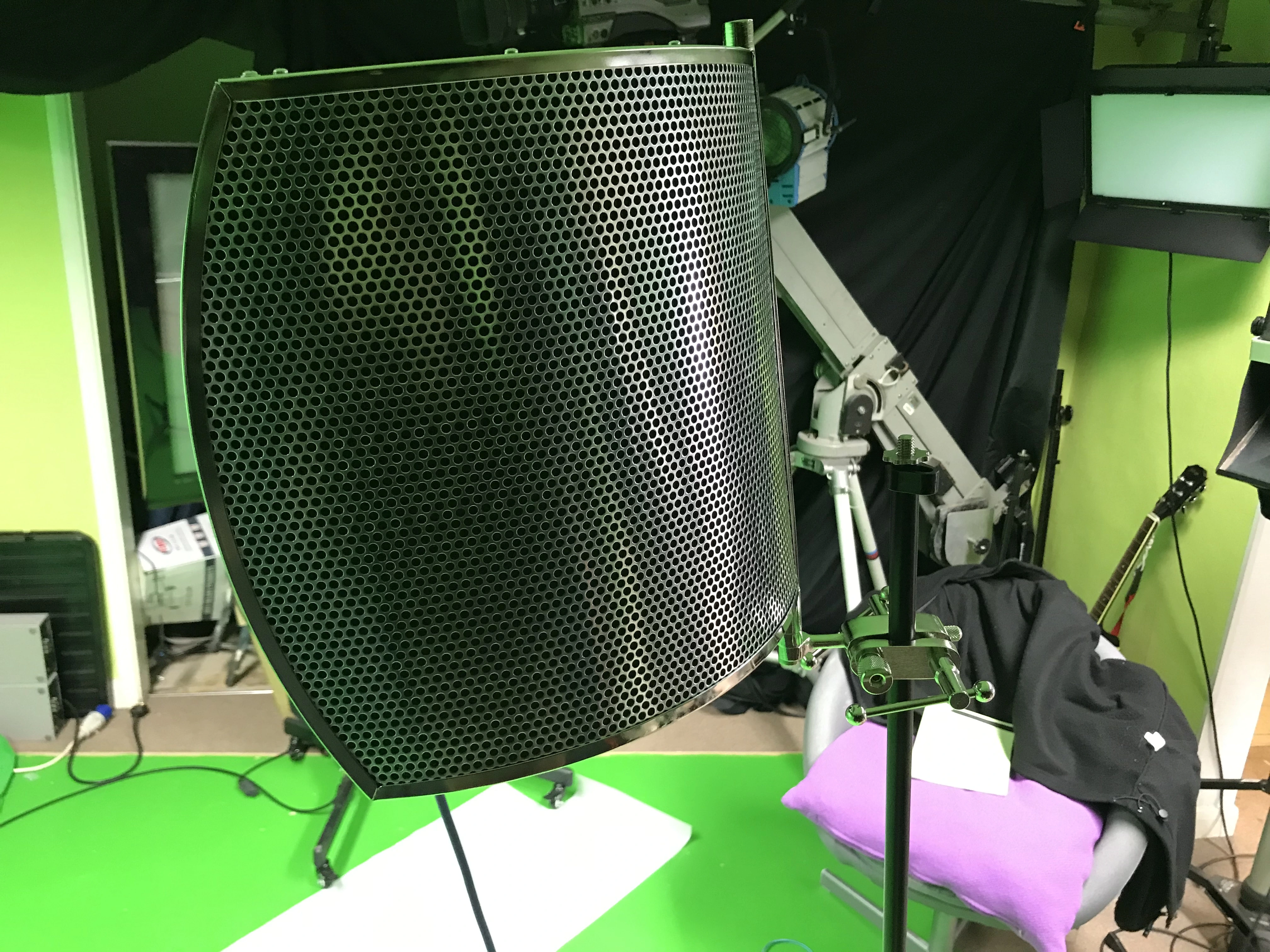

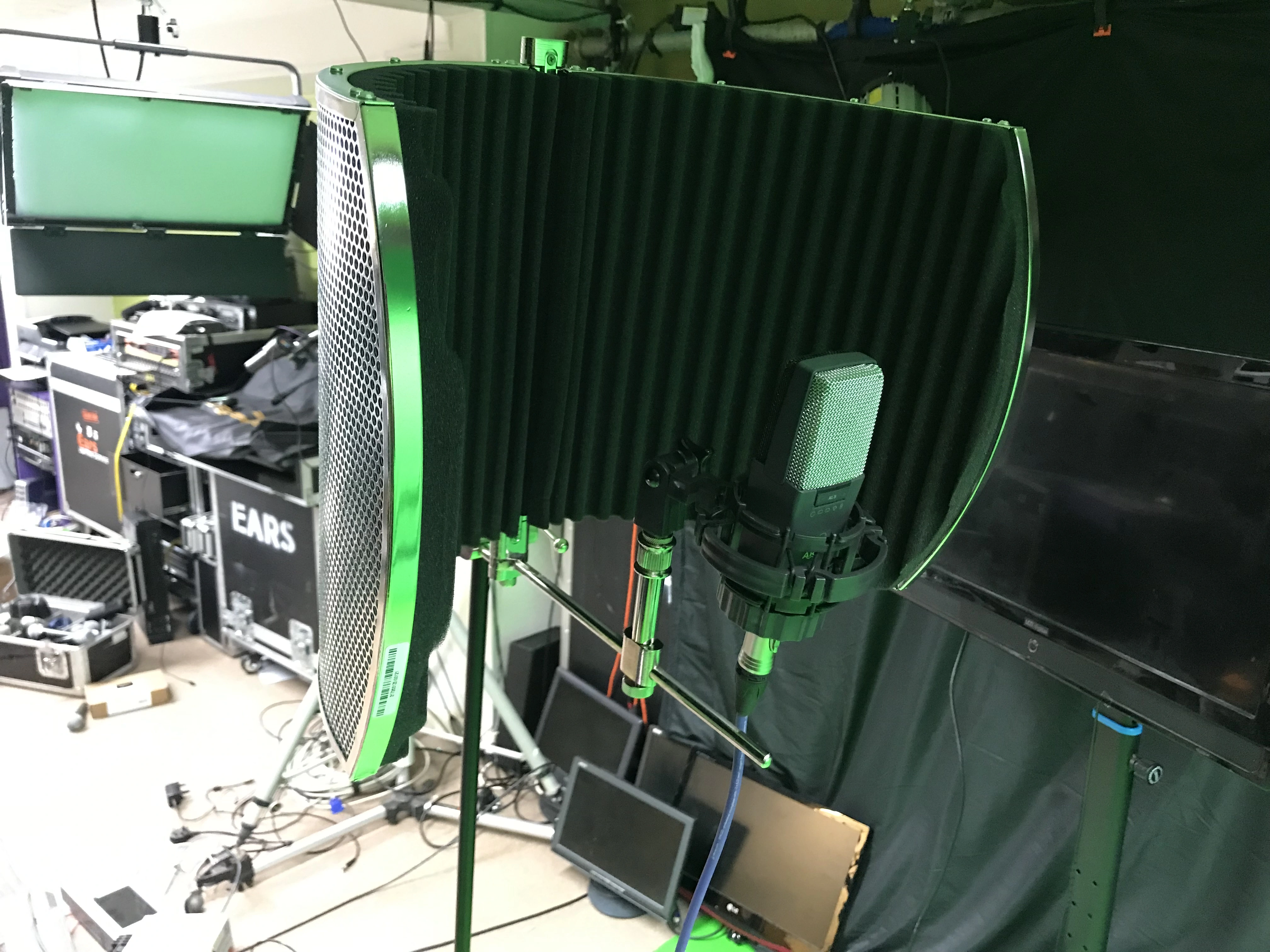

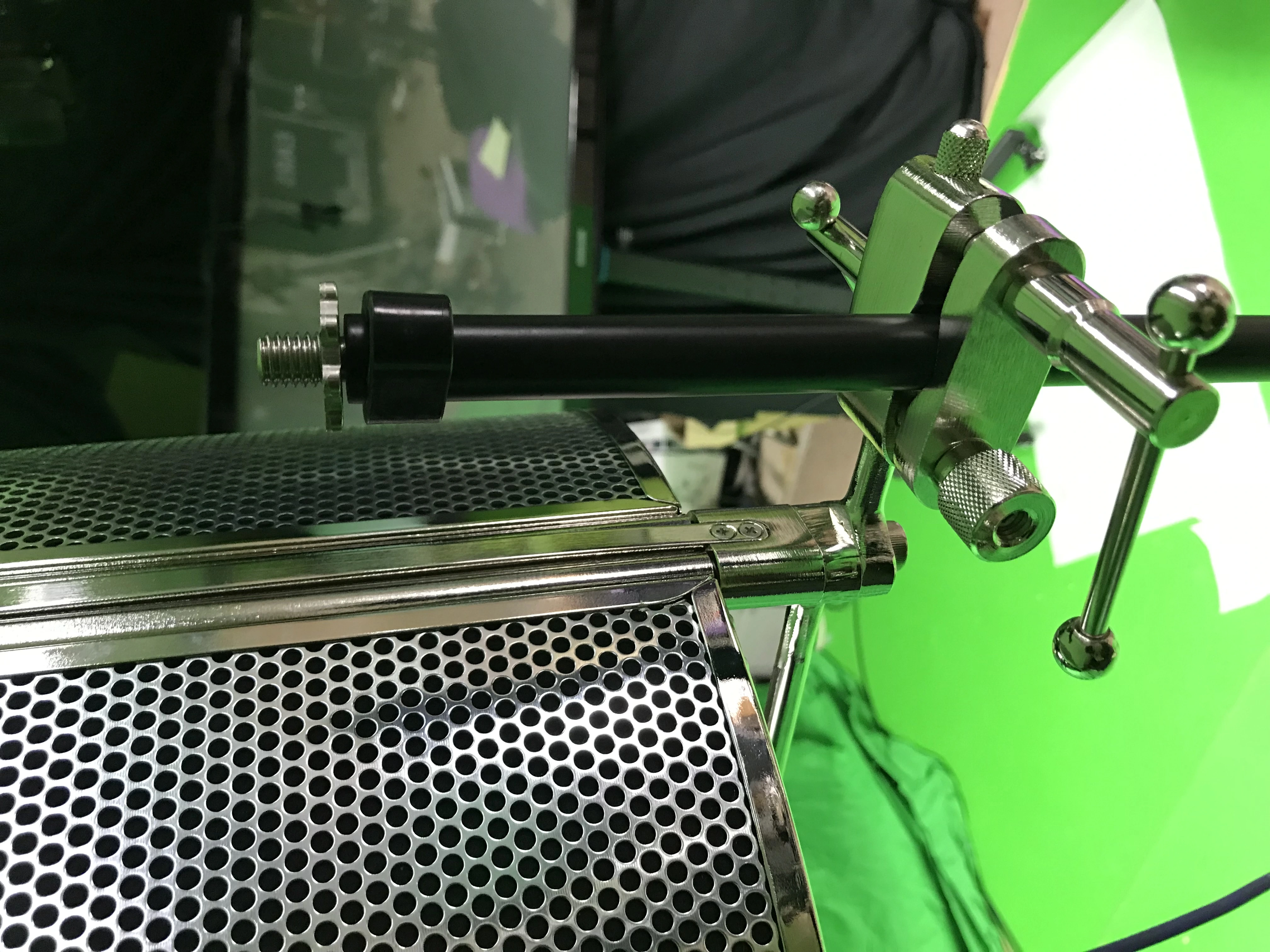

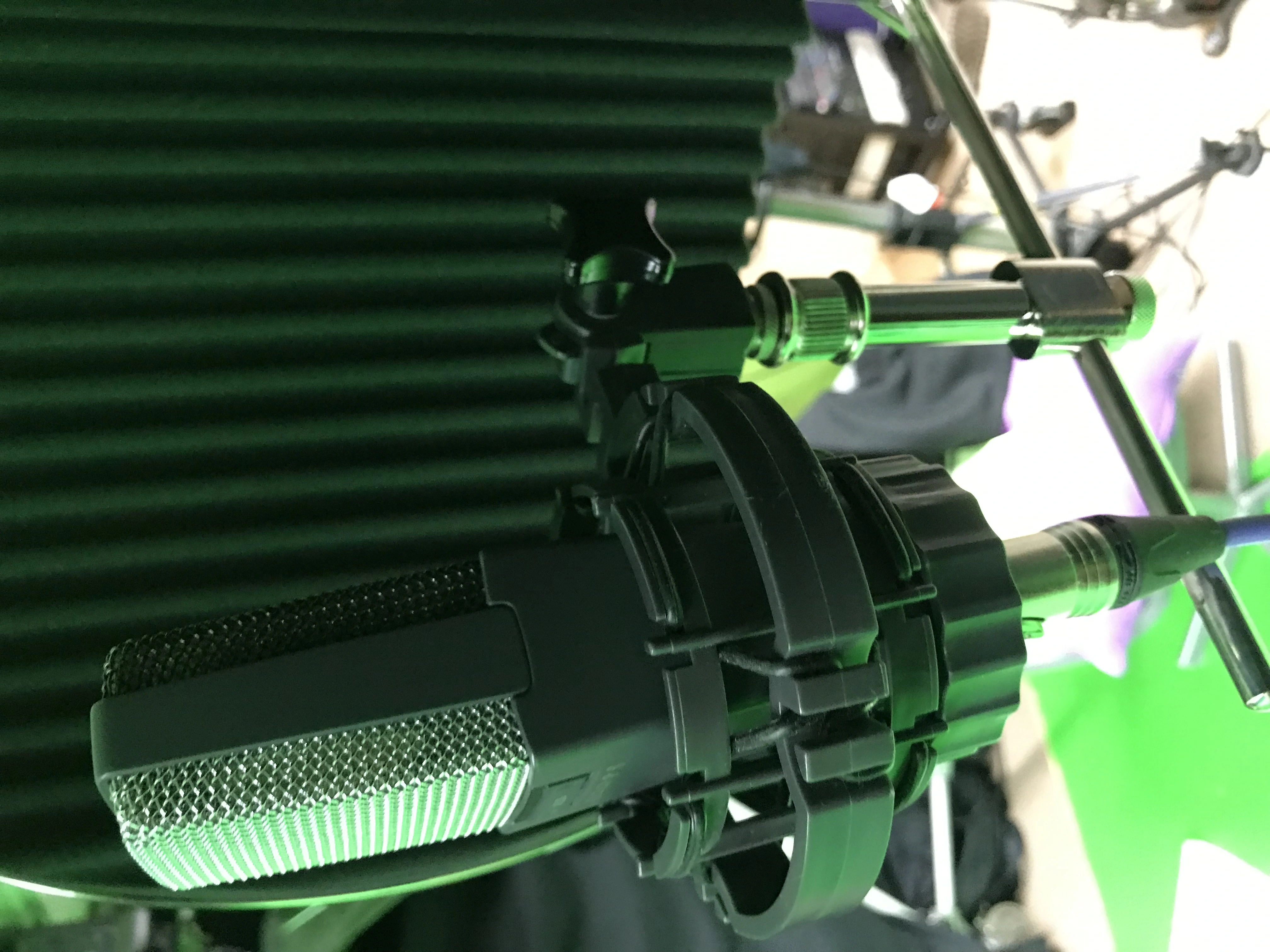

I got the screen this morning from Germany. It comes with a surprisingly decent hardware kit.
To explain the two audio recordings, I set it up in the office = desk, window to the outside world, computer fans, beeping emails etc - I did the recording on the AKG 414 in cardioid, with the screen between the mic and the window, and then without the screen. I noticed when my mouth was where the mic would be that there was a resonance - a sort of boomy sound quite obvious. A bounce from the frame probably, so I repeated the test with the mic set to omni - hoping to catch a bit of this sound, which I think I did.
I then moved to the video studio and repeated the test. On cardioid, there is some change to the timbre, but while speaking in the office area, it sounded quite normal while recording, but in the video studio where it's quieter, you do hear a more 'confined' timbre when you are recording in the bigger space, like I remember in the theatre. There is a reduction in room sound recorded and noise from outside I could hear was captured at a lower level with the screen as a barrier. I think I might be tempted to use it as a barrier in the stereo mode next time I do a recording where the mic position is a little too far from the source, but closer just isn't possible.
Here's some images to explain the hardware

Thank you for the demo, Rob. In the first clip, I couldn't hear any outside traffic or upstairs neighbors, but I did catch some room noise. Most of that may have been your computer fans (?).
The second clip was completely silent. Not even the talking from the open door.
To be honest it was a bit random, test wise. A train did go past, but I had the screen up and by the time I swung it out the way, all was silent again. I can hear a very small difference in ambience between cardioid with and without, but the coloration I can hear is there on the omni setting - but I don't suppose there's any point really even trying to use that for anything other than the test. It's going to be useful - but the results are less impressive than I had hoped for. I suppose it just cuts down rear pickup - so with careful placement could just make the cardioid null at the rear deeper?
I heard a difference in omni mode between the two, but the cardioid was pretty darn close to me. That would make sense to me, since it is supposed to cut room reflections. I imagine it would also help a fig 8 mode although although most people wouldn't use a fig 8 mode as a cardioid substitute unless it was for the tonal difference.
I bet a half sphere would be more effective, but it would probably tend to make anyone using is a little claustrophobic.
