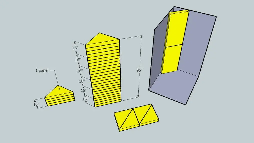

For an 8' ceiling, for example, 2 2'x4' 4" panels will cover an entire wall/wall corner, and if you go with 24" faced superchunks (cutting a panel in 8 triangular pieces) you need 50% more (3 panels).
No, you need SIX panels. 1 panel 4" thick, yields 4 diagonals which when stacked equals 16". 6x16"=96"=8'.
In this case this is 200% more.:) Big difference.
