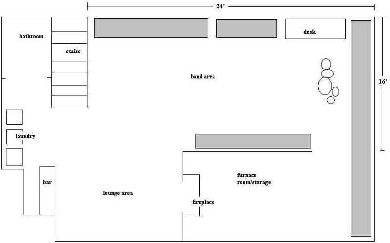

I guess I'm mostly interested in getting the best possible drum sound out of this room, but I'm also interested in possibly being able to spread amps out and track 2 guitars and drums at once. Also, this isn't my basement, it's my bassist's, and as you can see it is a multipurpose room (storage, kid toys, etc). And the final hurdle is budget. There isn't much of one. I could probably buy a few sheets of 703 or something to make a cloud, or some gobos, if needed. Anyway, just to start a discussion (if anyone other than me wants to have one) I'll start with some pics:
As you can see it's a pretty odd shaped basement, with several nooks and crannies. The exterior walls are all concrete block; the one interior wall is wood panelling (I'm not sure what's behind it, but probably drywall). The gray boxes are simply rough indicators of the excessive storage shelves everywhere, as you will see in the next few pics. I should probably mention that I am totally guessing on the dimensions.

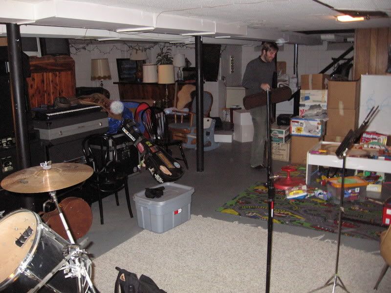

This pic is standing roughly in the bar area, looking back towards the drums and desk. Again, pretty cluttered, but it probably is helping somewhat to cut some reflections.

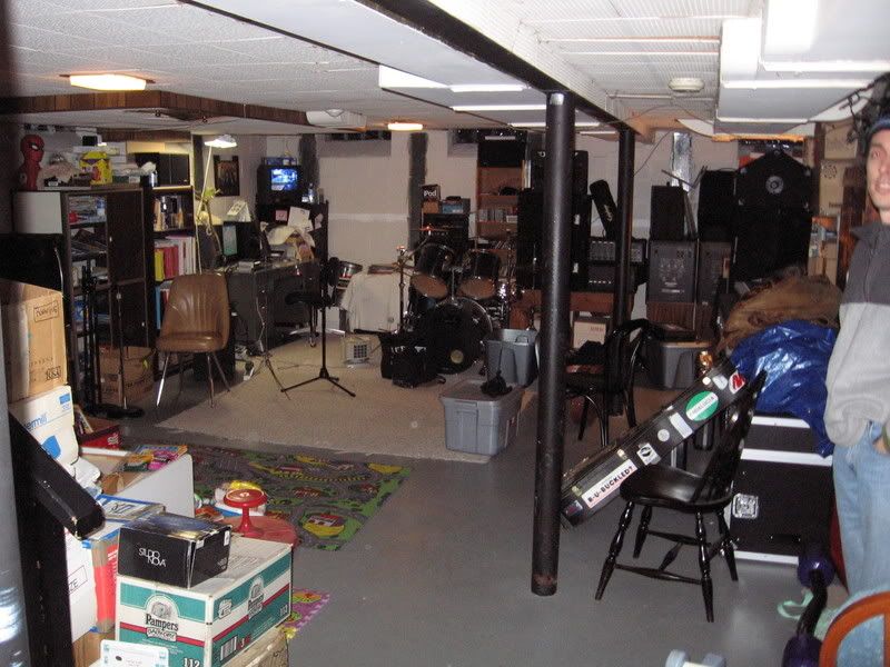

This shot is from the desk, looking back towards the bar/lamp collection, just to give you some further perspective.

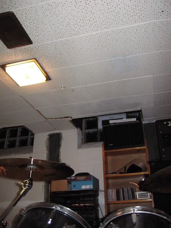

The ceiling is all typical acoustic tile. I don't really know if this stuff does anything for acoustics as far as we are concerned, though.

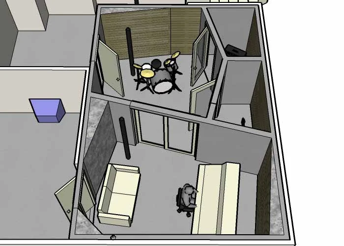

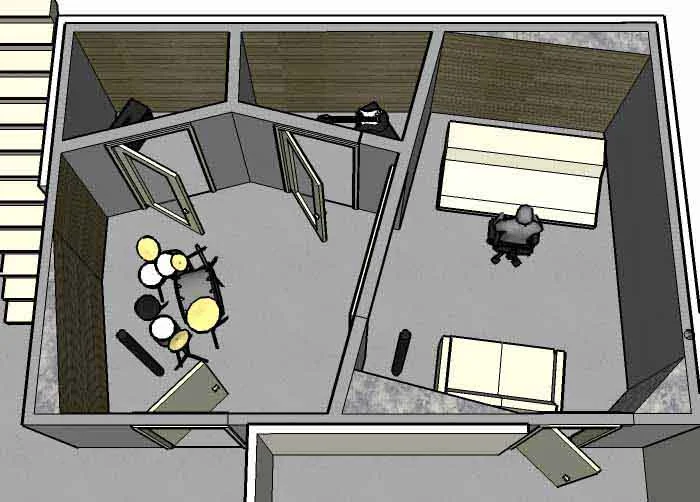

well first and foremost, cleaning up the place would help... clearing out the 16x24 area and stacking things around the edge would help make the place feel more like a room... removing things that buzz and humm (besides the musicians... :-) will help.
if you could pool together about a $1000 you could build a decent studio which in turn would attract a good drummer... you could leave off doors (in this design) to save money but you'd have acoustically OK rooms. the ceiling could potentially use a layer of sheetrock but you'd have to find out if the ceiling joists could support it... otherwise just shaping the space using 2x4 and sheetrock and some 703 fiberglass will make it decent.

wow, my man! Thanks for the effort. Admittedly probably more that we will be able to accomplish, but great ideas. I guess I'm looking for more temporary/portable solutions. At some point in the next year or two, I'll be doing a real construction in my own home, but for now, we are stuck tracking in the place I pictured. It's really not nearly as messy as the pics make it look. You know, the camera adds 10 pounds, or in this case maybe 10 boxes :confused:
You are right about the cleaning up and the buzz/hum concern. We might have to critically assess the sitch.
Anyway, we do have a drummer, for the record, sort of, that will be doing the tracking. But we are lucky to get him to show up once a month for a few hours. I guess I wasn't clear about that. I'll definately save your sketches for reference though. And you'll definitely be hit with some green rep for that!
