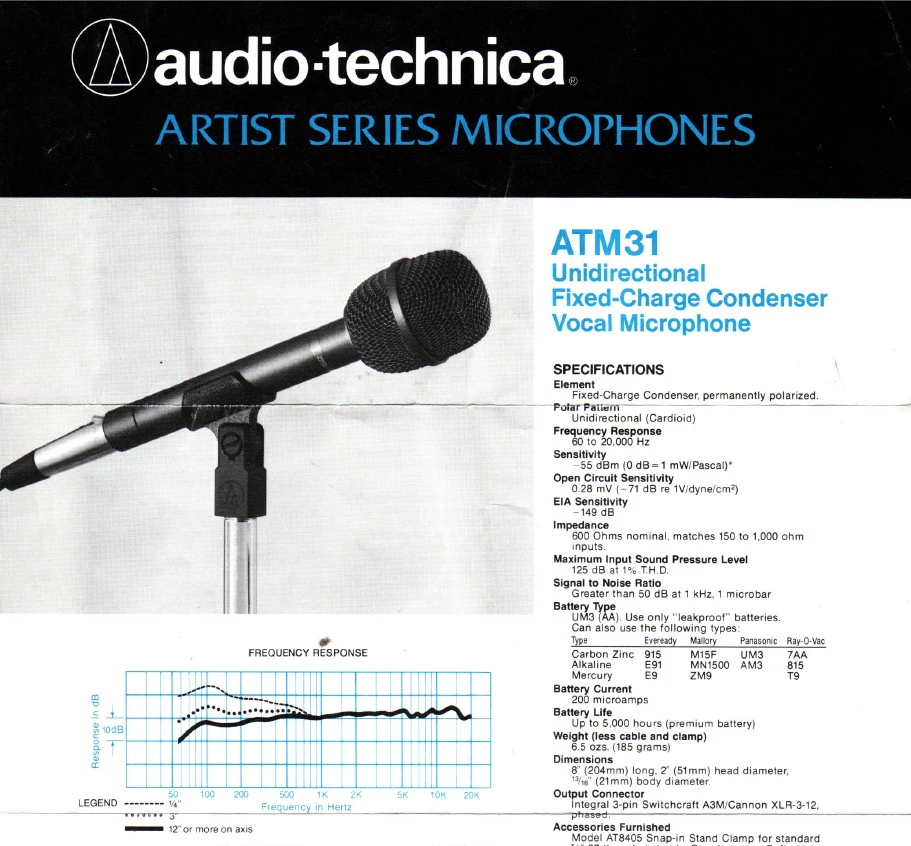

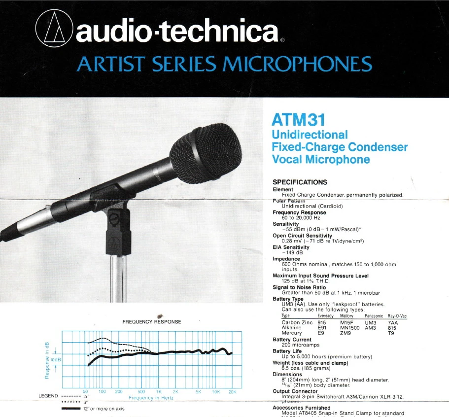

I have a ATM31 I bought back in 1990 ($138.60), one of the first good mics I ever owned and a descendant of your AT813. I bought it primarily to use with a Fostex X-15 4 track tape recorder which only has 1/4" inputs and a battery powered mic was a good option to allow use of a condenser mic with a recorder that had no phantom power available. Like your AT813, the ATM31 does not work when supplied with phantom power (I've forgotten this a couple times and wondered why the mic didn't work when I tried to powered with phantom).
I could be wrong, but I would think increasing the battery voltage may only increase the headroom of the mics internal amplifier which allows the mic to respond 'better' to louder sounds and maybe provide a hotter output, but not necessarily 'improve' the sound. My ATM31 is a good sounding mic I don't use often and handy to have if I need a mic with something that doesn't have phantom (works well with adapters into an 1/8" camcorder jack), but I don't think I'd risk a higher battery voltage that could conceivably damage it.
