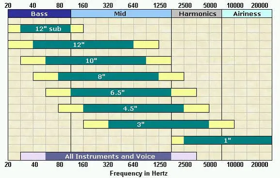

Hello guys.
Can you commend on this image. i'm thinking of buying 6" monitors but i am afraid that i will loose bass, i would like 8" monitors but again my room is 3,50m x 2,80m. so i'm trying to decide whats best
the size of your room has little to do with it. If you want lower frequencies, you'll generally want a larger driver. Regardless of what size you go for, acoustically treating your room will ensure that you get the most from your speakers.
