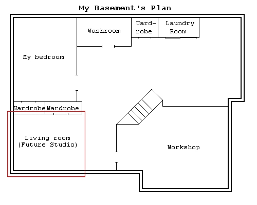

First, I'll show you a plan of my basement:

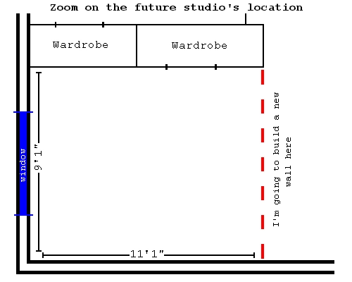

Now if we zoom in the future studio location:
Studio & Equipment (Part 3)
I plan to separate the area in two parts: The control room and the "recording room". I will separate the area verticaly (If you look at my plan).

You have nominated an area approx 9'x11' ......is that for both recording and control rooms? Because it really is barely big enough for a control room by itself.

Well, while I don't claim to be a pro at this but - I'd say as a first cut, it looks like you have a 9'x11' room, a computer, some software and a couple of mics... a good start for sure.
You talk about dividing the room up in two. That would make two very small rooms for audio. Is there any way you could use another of the rooms in your basement too? If not, then consider not dividing the room at all but using it for both recording and playback.

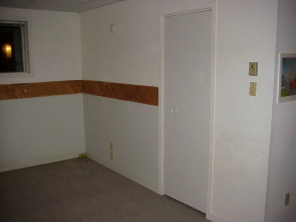

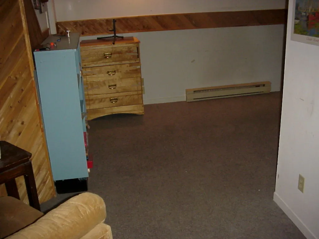

I could have some more space...
I could make this room 16 ½' if I puted the separation wall at another place.... I took some picture of the room so you can see what it looks like...

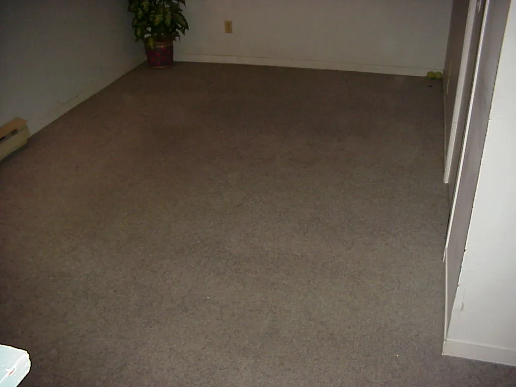

Picture 2...

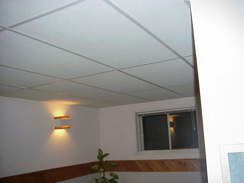

Picture 3...

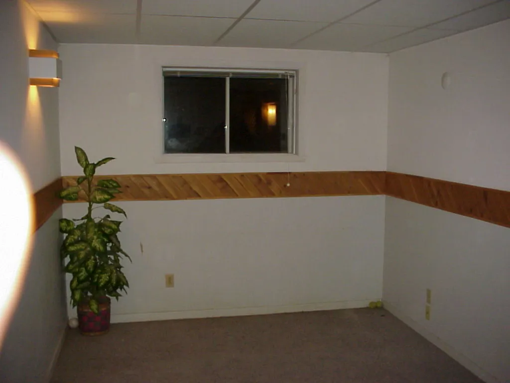

Picture 4...

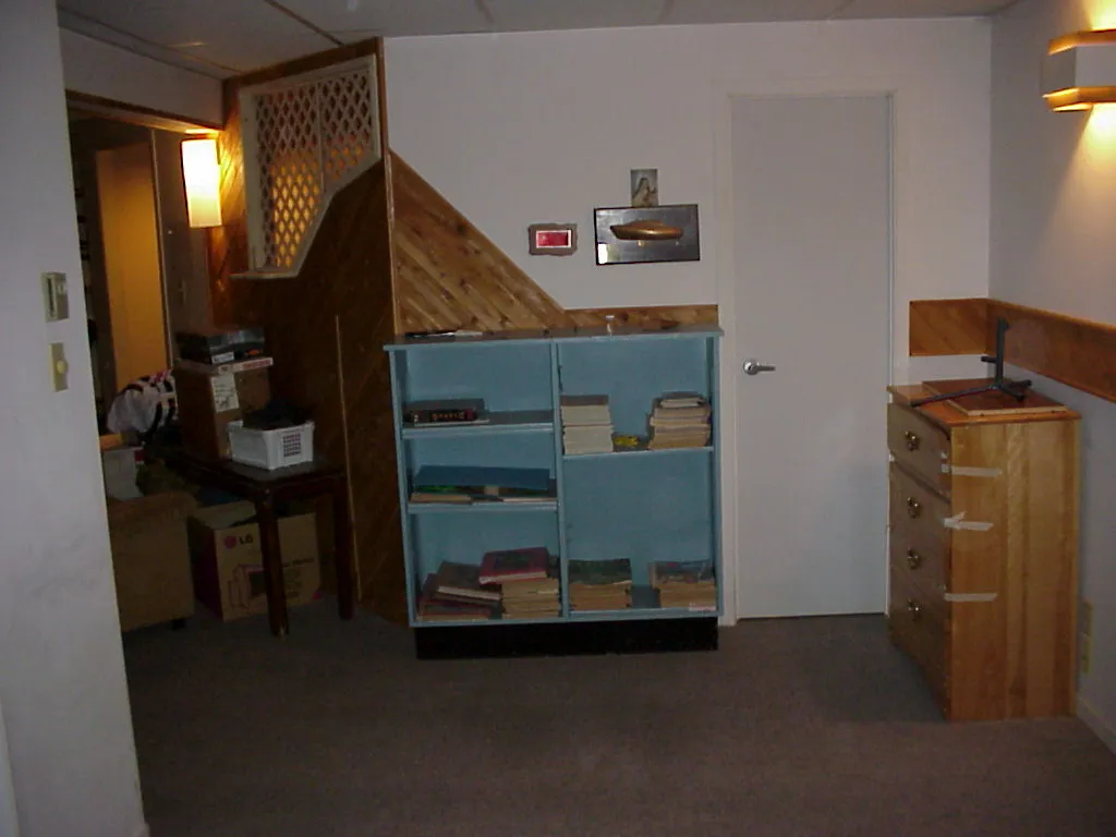

Last picture. Hope it will help you guys visualize the room and the space I got.
Ausrock: I'm a hiphop producer. I make instrumentals on my computer and then record and mix the vocals with the instrumentals. So this studio will be mainly used to record vocals; so I don't think I need that much space. The only equipment in the "recording room" will be a microphone.
Does a smaller space will change a lot in the sound? I mean will it make it sound bad or? Anyway, thank you for the help you've been giving me and the one you're going to give me (I assume :)).

Beathoven, I prefer not to tell you how to divide up your space cause I don't have to work in it. Also I am not into hipitty hopitty nor do I record to computer, so I don't have a real feel for your needs.........But to answer the best I can, it is usually considered that a small room is more difficult to "treat" than a large room. Doesn't mean that it will sound bad, just that you may have to mess around with acoustic treatment to get the desired results.
