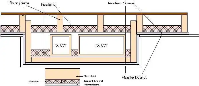

I am in the process of improving my basement studio. I want to finish the ceiling in the 11' x 19' room, but the area under the duct work is low and I don't want the sound to be transmitted through the house via the ducts. I want to use a suspended ceiling so I will have access to the pipes and wires above. Would the use of rigid 2" duct board under the duct and then packing fiberglass around it offer much in cutting down the sound transmission. Of course there will also be the acoustical tile.
I have attached a rough drawing (I hope) to give you a better idea of what I am thinking.

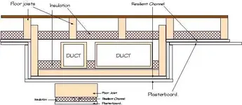

I'd try this.
cheers
john

John,
I know you probably can't give a definitive answer, but how effective can that method of "ceiling" be.
I have exactly the same situation here and from all I have learnt from your tutorials, I came up with the same solution........just didn't know what the end result would be.
ChrisO :cool:
I was hoping you would reply to this!!
Could I just run the resilient channel and plasterboard under the duct. Then I would put my accoustical tile ceiling (need access to pipes and etc.) under that, with 6" - 8" of fiberglass batts on top of the accoustical tile and along side of the duct work. This would isolate the duct from the bottom with the plasterboard and on the sides with the 8" of fiberglass.
I know your drawing is better but money and labor and I need access to ceiling area. How much would I be giving up in sound transmission?

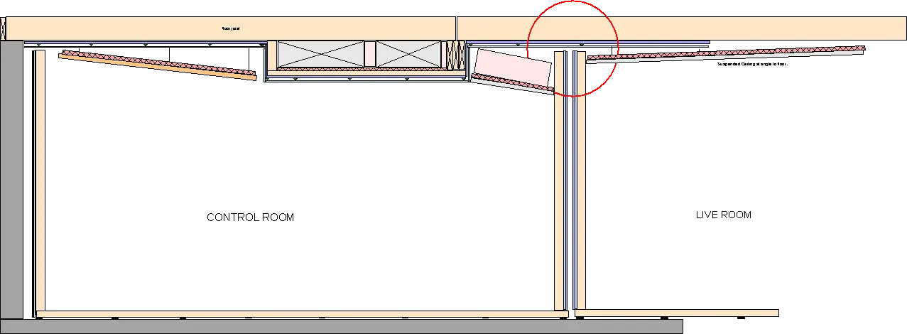

Ausrock, Larrye, John - My current dillema also concerns the ceiling and it is remarkably similar to Larry's... I'm guessing you have a "modern colonial" too Larry?
What I'm not sure about is what to do with the tops of the walls between the control room and one of my live rooms. See attached pic big red circle.
Should I stuff it with rigid insulation? Rubber? Any ideas would be appreciated.

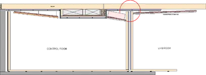

Here is the attachment from above.
Cheers
Kevin.

Longsoughtfor,
Looks like the two rooms share a common ceiling. Is there any way to cut the drywall and channel above the wall. If there is then you could extend the walls up close enough to seal it with caulking. I'm afraid if you want total isolation of the two rooms the ceiling will transmit quite a bit of sound into the other room.

Larry - I was thinking the treatment aplied to the joists would be to isolate the upstairs. Would splitting it reduce it's efficancy at doing that?
The hanging ceiling with acoustic tiles is planned to both seal off the room and provide a cheaper ceiling for my "room in a room". The other advantage was that I could install it at an angle and limit the mode set up between the floor and the ceiling.

The way I see it, your goal is to keep the sound within the room. If you do this there is no sound to go upstairs thru the cut out piece of ceiling. Without cutting the ceiling you have one room within a room instead of the desired two rooms within a room.

Hmmm... I don't know. That ceiling even with a cut is still connected to the same floor joists. The joists are perpendicular to the walls in this case. You may be able to tell I'm trying to avoid building another framed ceiling on top of my rooms.
My question is then: Can I seal a hanging ceiling well enough to keep sound from traveling (significantly) over the tops of the walls?
Kevin.

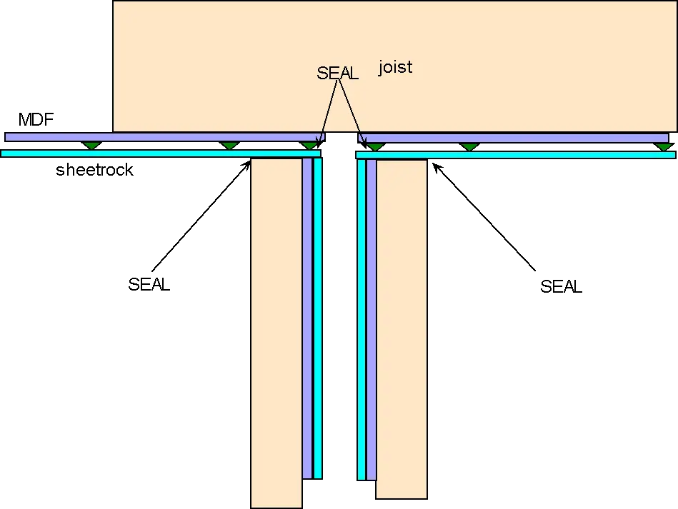

Larrye, Ausrock - That approach is sounding reasonable. One principle I thought I read though was that a sealed air space was a great insulator of sound. Resilient channel alone is helpfull as long as there are no holes even as small as a nail hole for air pressure (sound) to get through. In this approach, you would at least need to seal the edge where the cut (between the walls) so that the trapped air stays..well, trapped. See pic.
Does that make sense? I'm no expert either :) Just trying to do this so I don't have to redo it... right away anyhow LOL!
