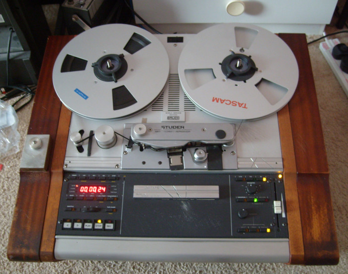

I am now the proud owner of a Studer A807 mk1. Pictures and stuff will be forthcoming. In the meantime, it won't fit on my rack trolley.
If anyone here has dealt with these machines, is it possible to remove the square things on the sides of the wooden panels?
Okay, I've figured it out. It occurs to me that this might be BBC-specific or something, but just in case anyone else is trying to figure out how to fit them to a trolley, the wooden side panels have a large, black bolt in them. If this is removed with a hex driver, it comes out to reveal an M10 thread. Unfortunately I don't have a 10mm drill to enlarge the M8-sized hole in the stand, but I'll deal with that problem tomorrow.
Here is the machine:
http://project-future.org/images/a807.jpg
It was shipped via UPS. I am tempted to post pictures of the packaging, either in this thread or Packing 101, because it was done pretty well.
Oh yes, if anyone knows the pinout for the external VU socket, that would be awesome as I'm still wondering how to jack my VU rack into it (it wants RCA, the Studer uses XLR...)

Anyway, I've got the stand together, by sheer luck and force of will, since it was not designed to interface to a Studer like this.
https://i89.photobucket.com/albums/k216/tapewolf/tape/a807_stand.jpg
The VU is being fed off the headphone jack I discovered last night. I believe the recording itself has the level skewed - I'm going to check that out later, but probably not today as I'm shattered.

This particular one is being an utter bitch. It doesn't seem to want to feed the input directly to the line output as the buttons to do that have not been installed. It has no internal VU meters, and 0dB from the mixing desk in balanced format does not seem to correspond to 0dB from the deck itself.
My 'scope has just packed up, I have no frame of reference to work from and generally I despair of ever getting the thing aligned.

Well, I've used a softscope and got the record and repro heads lined to each other (the repro was lined against my MRL, but given the 'scopes errattic behaviour I'm going to have to double-check it, I think.)
The Lissajous figure was slightly kinked into a figure-8 though... I've never seen that before, but I got it as flat as I could. I'll put it down to the pinch roller being out-of-spec (i.e. from a Revox B77).
Calibrating the input and output levels themselves is going to be an issue, though, unless I can get the VU meter to talk sense. It doesn't help that this is my first experience with balanced-only equipment and the VU rack is expecting -10...
Right. I'm still a bit concerned that my inability to cross-calibrate between the VU meter and the deck may have left it in limbo-land, but the recorder does now seem to be internally consistent and is roughly aligned to the standard I was using on the Revox.

One thing that does concern me is that I had to increase the repro gain on one of the channels quite a bit more than the other to get them to match... This leads me to wonder if the repro head is out of alignment in terms of height (they are pretty much phase-aligned). Visually it looks like the tape is dead-centre over the butterfly, so I'm not honestly sure.
I have not touched the bias or treble settings yet, which probably accounts for the unusual bass response in the tape version. Traditionally I've always been afraid of screwing up the bias, though with the A807 I have the advantage of being able to copy the original settings and re-enter them if it goes pear-shaped.
Any comments, suggestions etc would be helpful. I'll also try to post some video later. And the packing...
