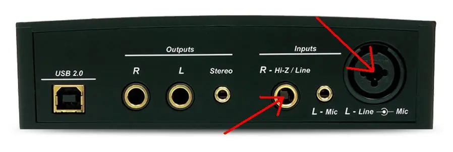

Anyway, the adapters should have a 1/4" female and RCA male setup. You need to plug a 1/4" cable into each adapter, plug the RCA end of each adapter into one of the RCA (red or white) outputs in the 488, and then plug the other end of the 1/4" cable into the 1/4" jacks on the 0204. I have attached a picture indicating where these jacks are (one is by itself in channel 2, the other is in the center of the Neutrik combo jack in channel 1).

Then in your DAW, set two tracks up so that one takes from channel 1 of your 0204 and the other takes from channel 2 of the 0204. Keep your volumes set the same for both inputs.
Then record in the DAW with 488 playback, and pan the tracks you recorded all the way left and right in your DAW. It doesn't matter if your cables go into the wrong inputs and your L/R channels get reversed on playback because you can switch them around again by panning in the DAW.
