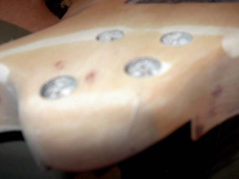

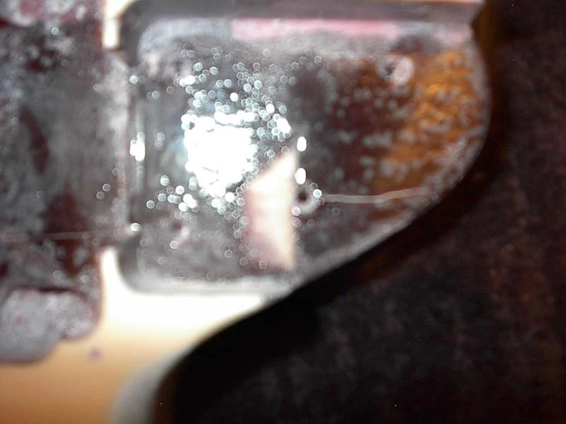

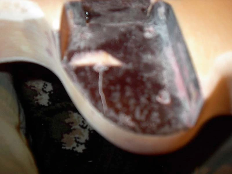

I'm posting a couple pics but they're pretty shoddy. Simply couldn't get a good and up close photo. The crack is tight...no gapiosis to speak of. To get any glue to flow into this crack is going to be next to impossible unless there's a product out there thats really really thin.
Thin CA is you best bet. It will "wick" in no problem. Don't use a kicker to set it off let it cure n it's own. I wouldn't Imagine you'll have a problem with it opening up more once it's bolted up. If you do then you'll need to cleat it as I described.
