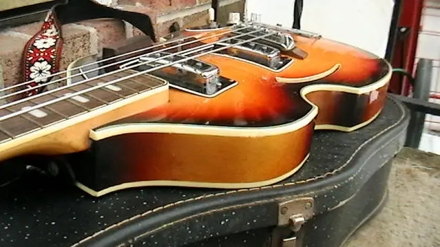

This bass might need a slight adjustment in string height....
