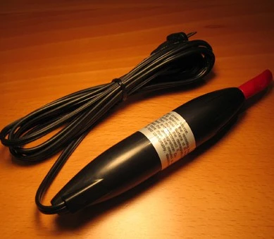

Yes you can find demagnetizers off of eBay for $12 that look like the one pictured below. I own one. As a dissatisfied customer let me tell you from personal experience that there is no cutting cost corners with a demagentizer. That $12 jobbie might be good enough to demag cassette heads, but it will not effectively demag open reel heads. It is a waste of time and money. To do it right you have to pay the money, and that would be my advice if you plan on keeping the 32, which is a nice half track transport with good parts support and a good user base right here. ;)
