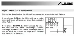

Hi peeps , my unit loses memory, specifically the tempo last used when the unit is switched off, regardless of running on AA batteries or AC. Presets are fine. I'm quite prepared to open her up but thought it prudent to ask if anyone else has had the experience or issue. Cheers.
How do you have the tempo set per the image below? If it's PERPAT the tempo is stored with the patch and should return to that value when the machine powered on. If the GLOBAL is like my SR16(SR16 only has GLOBAL), the tempo is retained and will store its last set value when powered on.

I use mine in Global mode, and it always returns to 130 bpm regardless of what tempo I was actually using. Must be the backup battery?

Not to mention even the Global mode returns to Perpat mode on power down. Frustrating!

Well, I hope it has a battery!! I don't have any user patterns onboard, but all my settings reset to standard on power down. I was hoping that the architecture was similar to sr16. Gees, hope there is a battery onboard!!!

Okaaaaaay.... I went in (nicely built device!) but no battery., as such, might be an E^2 type memory. So I checked the way I was attempting to save my user settings, and I forgot to save each one as I was changing it!! Simple forgetfulness. Save each function you change in user settimgs as you scroll through, now the machine is brilliant again. I'm such a fook!

That appears a bit different than the SR16 in that if the tempo is set to global it just retains the tempo setting without performing any kind of save action. Good to hear you got it sorted out.
